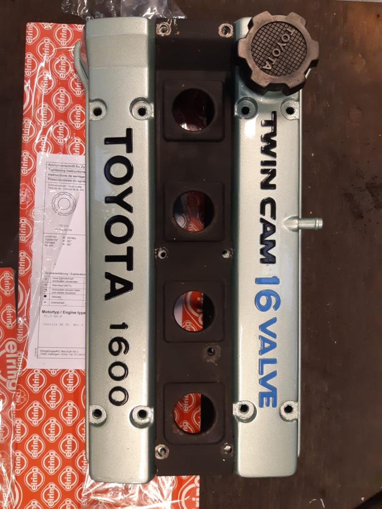

[Image: AEU86 AE86 - NL: Robert]
They even repainted te valve cover
Before
After
Was advised not to go over 4000rpm for the first 5000km.
What do you all think of that? Seems quite long to me...

5000 kilometers not going over 4000 rpm sounds a bit excessive. Highway speed (100km/h) is already 3300 rpm in 5th as well... Big Grin
Perhaps Oldskewtoy can say more about it as he's about the most experienced 4AGE builder we have here. Wink
