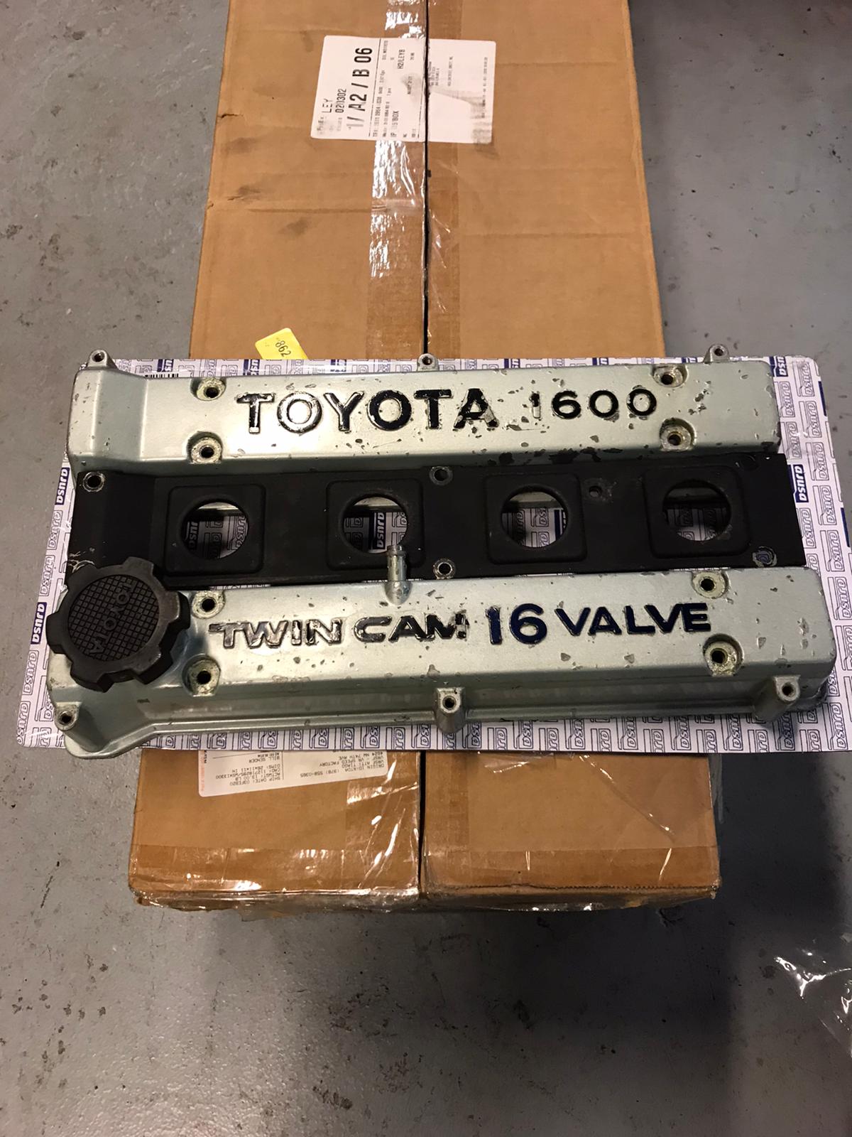

[Image: AEU86 AE86 - NL: Robert]
They even repainted te valve cover
Before
After
Was advised not to go over 4000rpm for the first 5000km.
What do you all think of that? Seems quite long to me...
