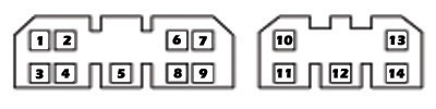

Small hint: I used an Mitsubishi (1996+) ISO harness and remodelled it to a toyota according to this link:
http://www.dorikaze.ca/dorikaze_guides_d...php?a_id=2
This is the pin-layout:
[code:1]
1983 to 1986 Wiring Harness:
Pin What It Does Colour In Dash New Harness Match
1 Right Front Speaker (+) Green Gray
2 Left Front Speaker (+) Pink White
3 Right Front Speaker (-) Blue Gray w/ Black Stripe
4 Left Front Speaker (-) Purple White w/ Black Stripe
5 Ground Wire Black Black
6 +12 Volt Ign Wire Gray Red
7 Power Antenna Wire 1 Blue (join wires 1 &2 together
8 Power Antenna Wire 2 to this blue wire)
9 Do Not Use
10 Right Rear Speaker (+) Red Purple
11 Right Rear Speaker (-) White Purple w/ Black Stripe
12 +12 Volt Battery Wire Blue w/ Yellow Stripe Yellow
13 Left Rear Speaker (+) Black Green
14 Left Rear Speaker (-) Yellow Green w/ Black Stripe
[/code:1]
Then you can place any ISO-connector compatible radio in your hachi. Smile

Hey thanks for those layout. I am planning to put ISO-connector when I bought new cd player. So I can use this!! thanks again banpei

I've done mine a few months ago and know how much pain it is to find the correct data. Wink
I asked at three dealers if they knew anything, visited various car-parts shops and searched the internet and still found nothing. Undecided
Lucky enough I found the mitsubishi connector looking familiar. Hurray!
I also found the mitsubishi pin-layout, it's the second one. Unfortunately only in pdf. Undecided
