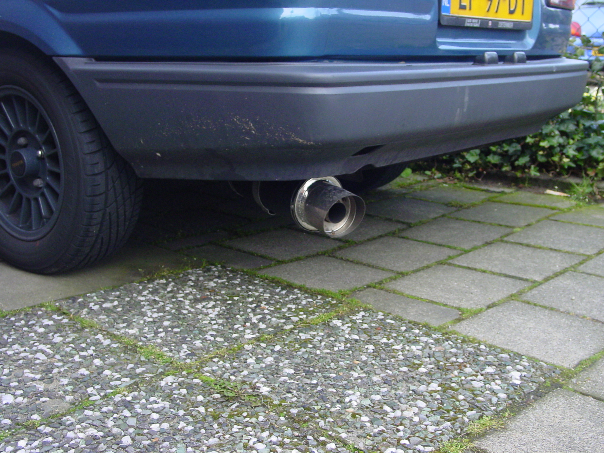

Yeah, and I join the ranks of riceboys too!!!
