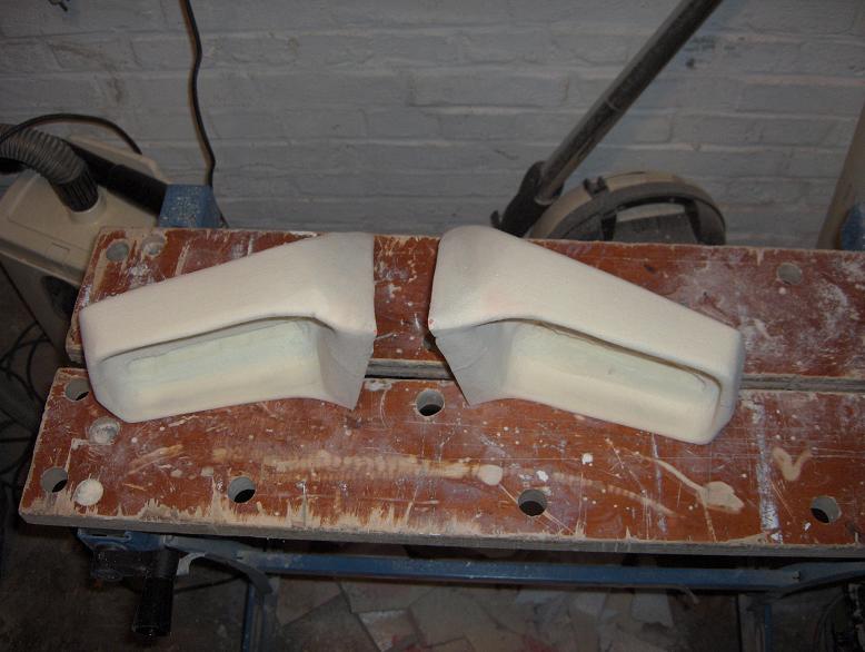

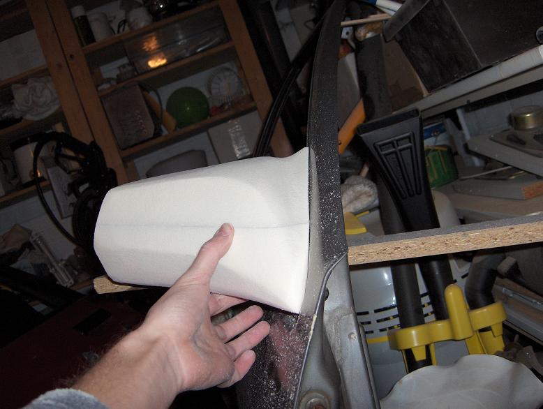

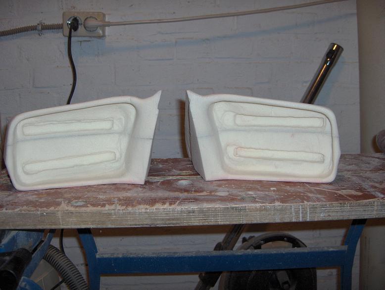

A friend of mine started a project of making new mirrors for my car.
check it out:
[Image: AEU86 AE86 - Mirrors (Hand made)]

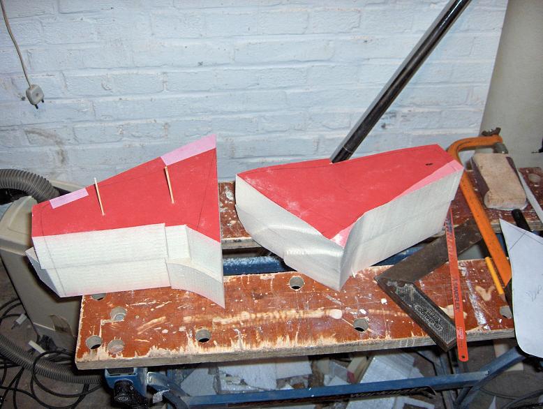

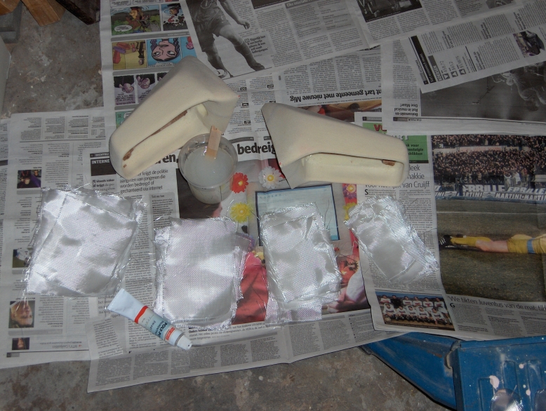

and more

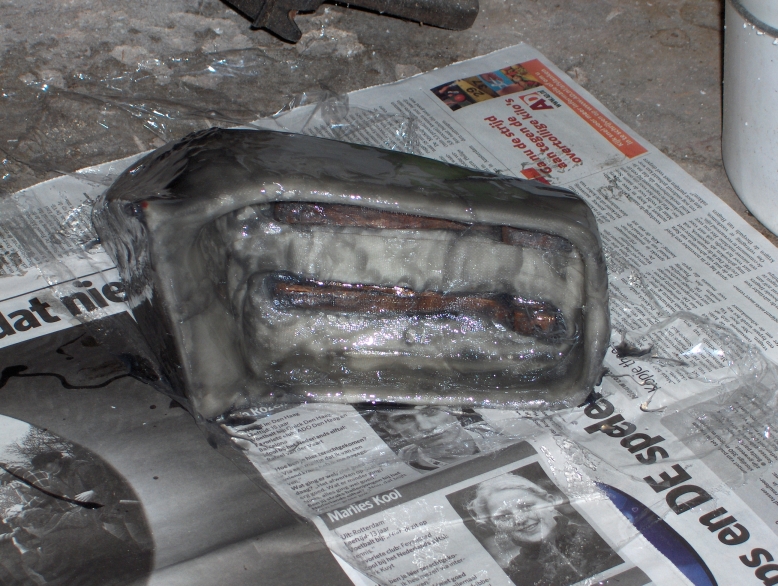

Mirrors (Hand made)

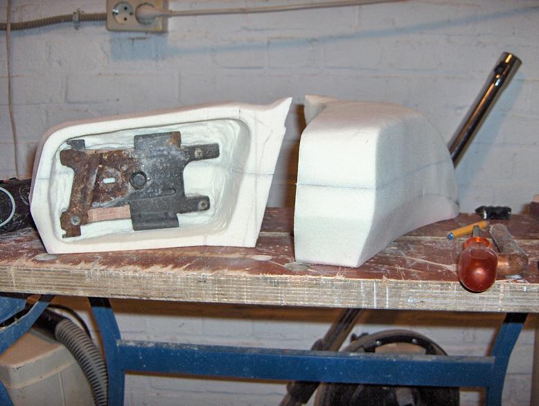

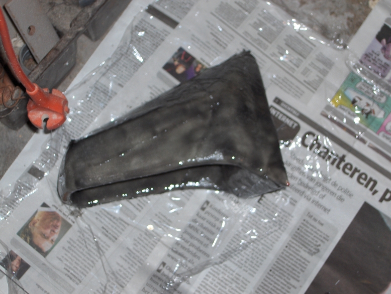

Today the mirrors are laminated, see pics below
After this the mirrors are sanded smooth. Depending on the strength they get another layer with glassfiber. As a finishing touch they get a black color with protection against uv light.

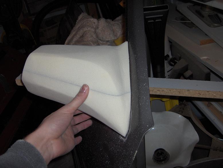

Mirrors (Hand made)

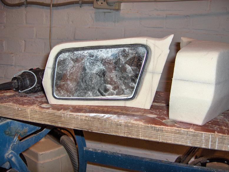

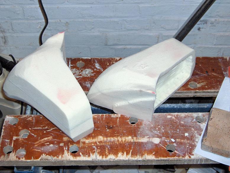

The used material for the outer layer is glassfiber and epoxy. This is the cheaper version of carbon.

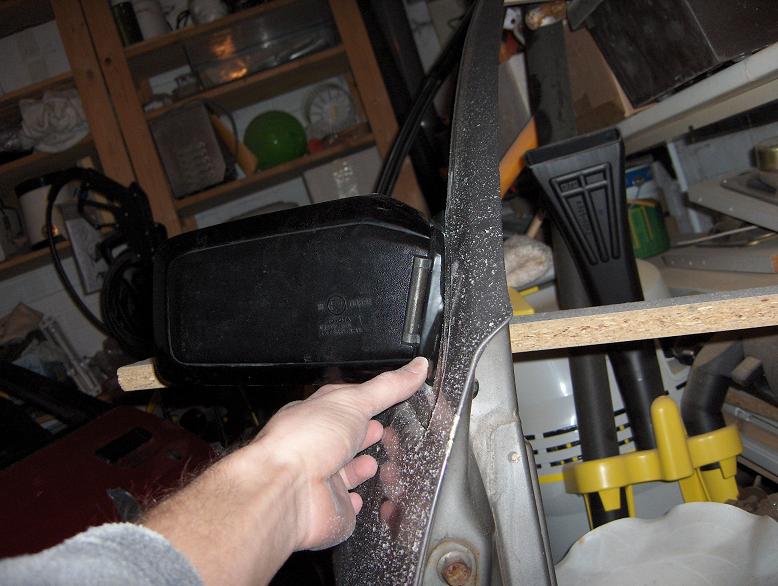

The inside is just foam with a fine structure so you can make really nice shapes

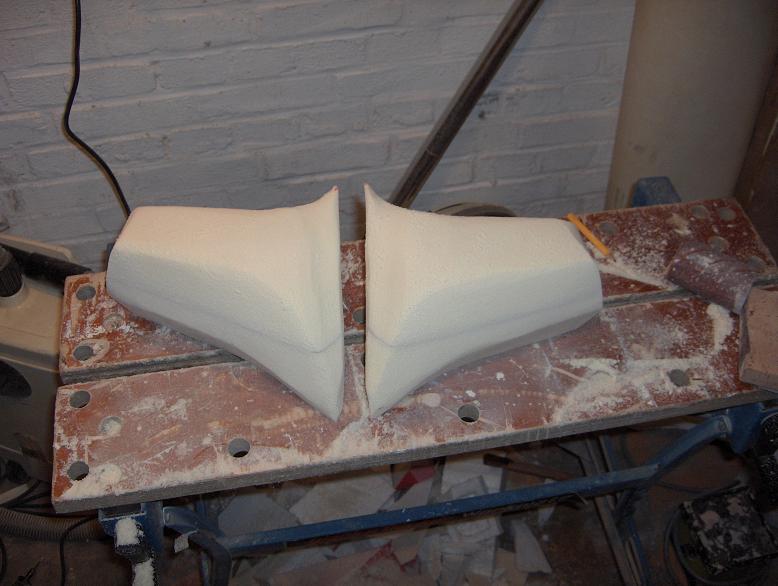

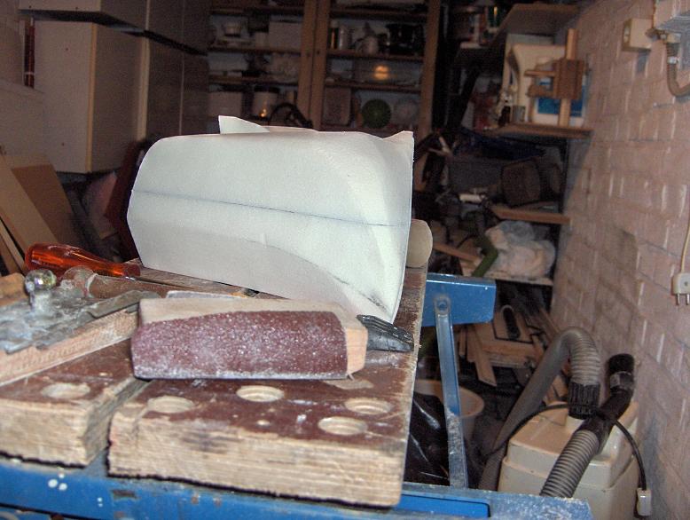

Thank you all for the positive reactions ! Cool

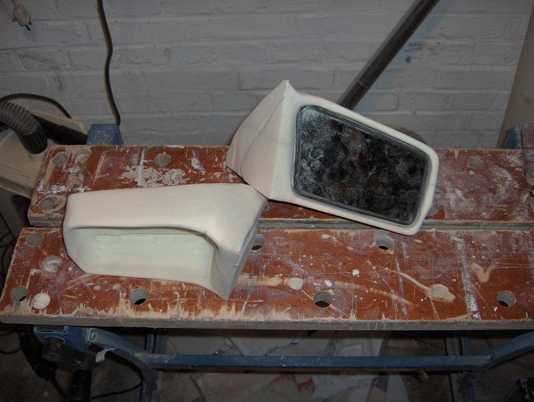

Today i've got rid of all the rough surface by sanding the mirrors. They are all smooth now Smile. I also made the connections to the door (litte white things).
What is left to do:
Make them fit perfect on to the doors
Another layer of epoxy and some glasfiber.
sanding them again to make them super smooth
An then hopefully the finishing protective black layer
Mounting them on the car..... but that is if everything goes as planned haha Respect!
