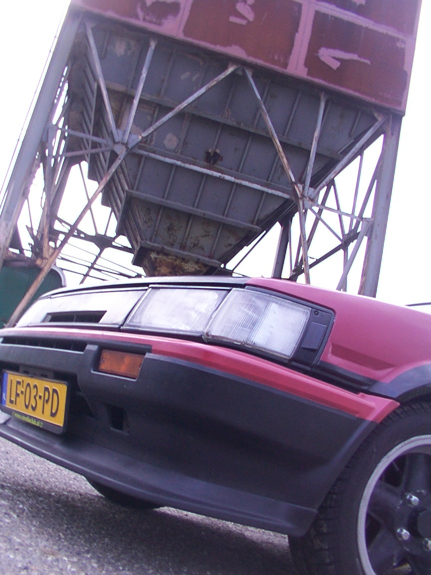

The mounting holes on the fenders are not the same for zenki & kouki though (easiliy fixed), and the lines will be "off" when mixing and matching zenki & kouki headlights and corners. This is because the kouki's have those little lids on the headlights, the corners have a thicker black line on top and bottom too because of this ( so the lines continue into the corner lights).

No, there arent going to be any problems, it will just look a little odd at the corner lights. I've done the exact same thing to my own hachi, didnt want to fork out money for new kouki corners, and couldnt find used ones.

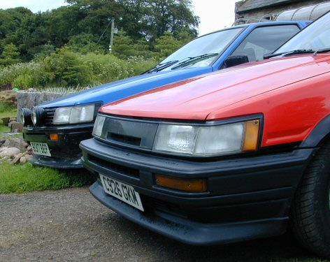

It will fit just fine, no fitment problems as long as you keep in mind that you need to keep the grille and headlights of the same type since the grill mounts are different. But the sidelights will not match with the headlight trim. Personally I thought mine would look better with kouki sidelights.
Have a look.

Look at the differences in the tops of the corner lights.. the kouki ones have a much thicker black line there. The zenki corners have a thin line that does not even go all the way to the headlight. Maybe I'm a bit too fussy, but it's just a cosmetical detail. Anyway, enough about that, best of luck with the project.
