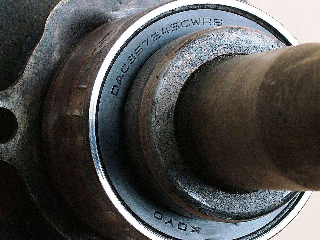

Bearing for the rear axle. Just pictured Wave

bearings for the rear axle and diff:
12? LM501349/10 KOYO x 2
16? M86649/M86610 SKF x 1
18,5? HM88649/10 SKF x 1
Total 58,5?

Man, use your brain cells, not nmwisima's ass. Tongue
2 same bearings = one for each axle = koyo
2 different ones = for diff = skf Wave :wink:

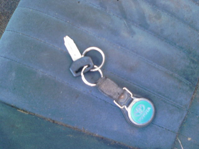

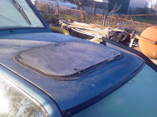

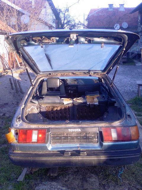

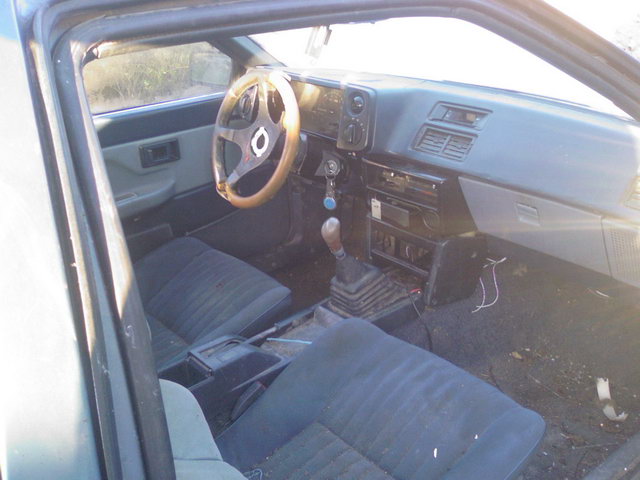

OK, as I writen elsewhere I bought another hachi.
Description: blue metalic AE86 zenki GT, Bluetop 4A-GE MAP engine, 201k km on oddo, car is dented and scratched everywhere. There is no good panel on it. Doors, hood, hatch is rusty, sideskirts have big holes, all 4 fenders rusty, position lights broken, rear lamp broken, sunroof is bad, all seats have holes in them, there is no key (half of it is broken in lock) so no steering at the moment, windshield is broken....
I'll post the pics now, some of them from the morrning. Later I washed the car so it looks bit better now.
