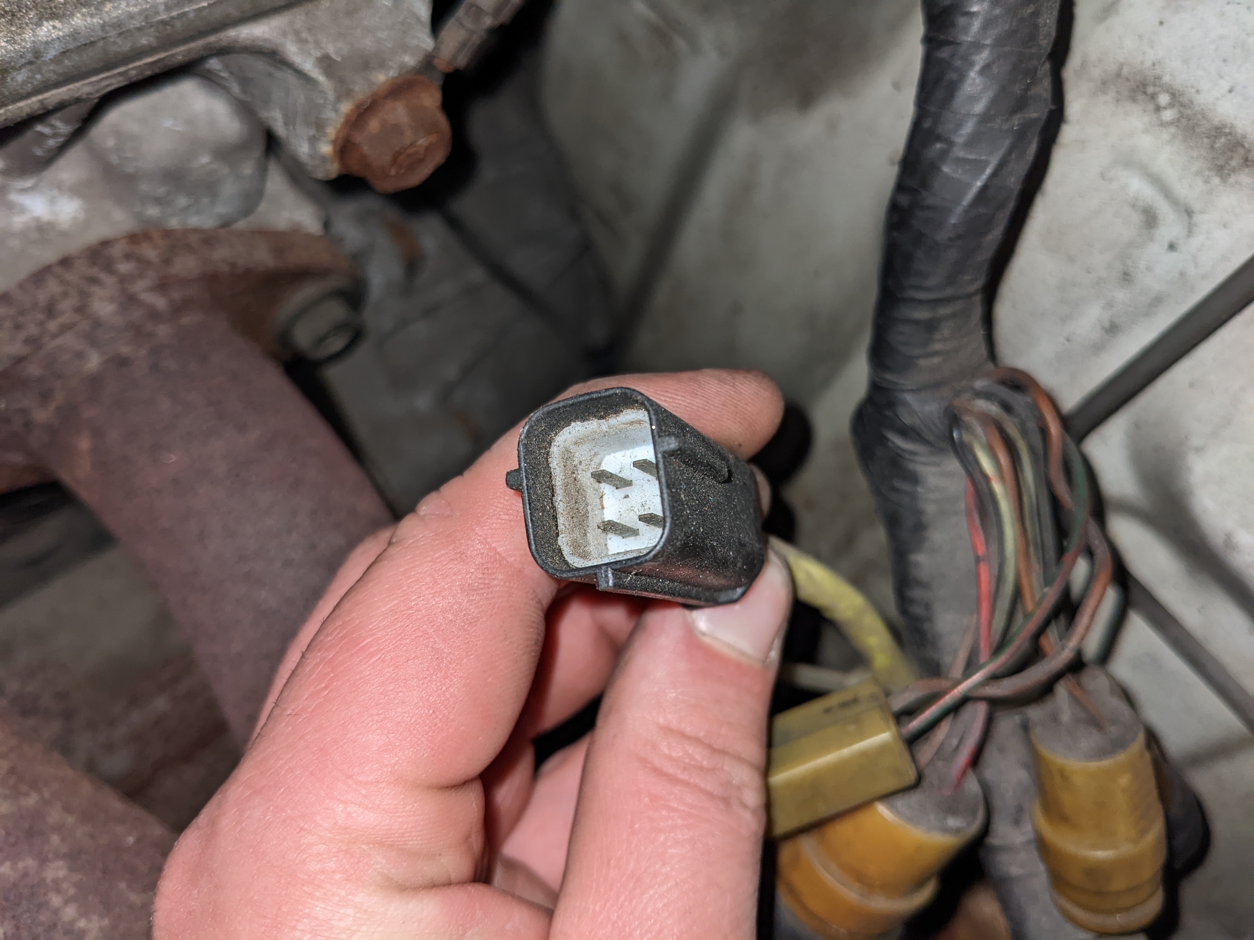

I am looking for a bit of help getting my 86 running a bit better. It is running very rich currently which I think is because the lambda sensor currently isn't plugged into anything.
However there doesn't appear to be a plug on the main loom to plug it into, either I am being an idiot and just can't find it. Or it could have been cut/removed for some reason.
Could anyone help me with a picture or video of where the lambda sensor wiring should be on the main/engine loom?
I will attach a picture of my plug on the current sensor
It's a zenki 84 Japanese model if that makes any difference
Thanks
[Image: AEU86 AE86 - Lambda sensor wiring]

Wrong sensor ?!
On all the AE86 I worked on, those who had a lambda sensor (from factory) where all a one wire sensor.

Indeed. It should look like this:
Maybe they installed a random sensor?
05-11-2022, 02:15 PM (This post was last modified: 05-11-2022 02:16 PM by Power_uP.)
I've seen a few imported 86s with cat wires that go absolutely nowhere, so you don't have anything too unusual. I doubt that's the cause of the problem.

OK well that's good to know I think! Atleast I don't have dodgy cut wiring to chase up.
I have a bunch of unused plugs in the loom above the exhaust manifold, so I expect one of those could be the original lambda plug. Is it worth trying to source the correct sensor? I imagine a one wire sensor isn't going to make a huge difference to the running of the engine?
My car does have a cat fitted, which I thought was a bit unusual for the age of the car.

I have attached a picture of the other sensor on the manifold, it's a single pin connector but I think it looks more like some sort of temperature sensor than a lambda?
I am currently making a decat pipe to replace the cat, I have a feeling the cat isn't factory so I'm unsure if it should/would have had one from factory
