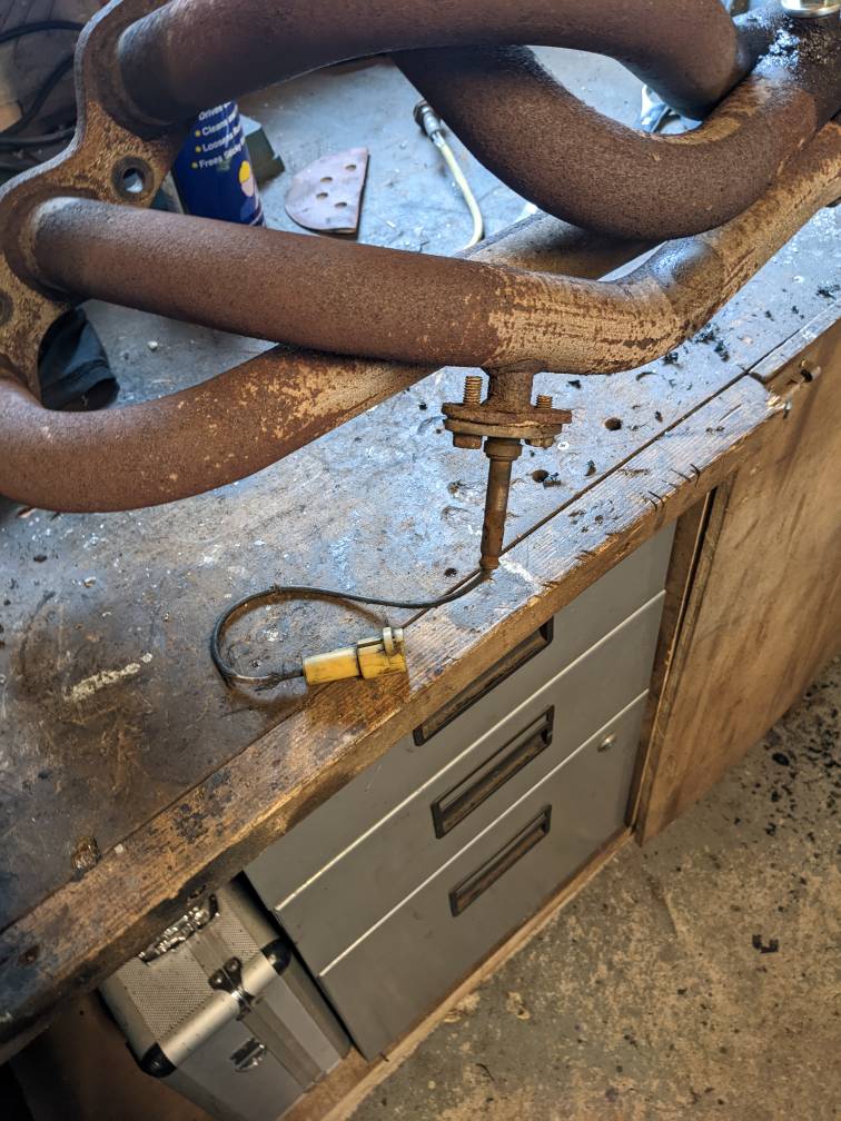

I am looking for a bit of help getting my 86 running a bit better. It is running very rich currently which I think is because the lambda sensor currently isn't plugged into anything.
However there doesn't appear to be a plug on the main loom to plug it into, either I am being an idiot and just can't find it. Or it could have been cut/removed for some reason.
Could anyone help me with a picture or video of where the lambda sensor wiring should be on the main/engine loom?
I will attach a picture of my plug on the current sensor
It's a zenki 84 Japanese model if that makes any difference
Thanks
[Image: AEU86 AE86 - Lambda sensor wiring]

Wrong sensor ?!
On all the AE86 I worked on, those who had a lambda sensor (from factory) where all a one wire sensor.

I've seen a few imported 86s with cat wires that go absolutely nowhere, so you don't have anything too unusual. I doubt that's the cause of the problem.

In Europe, most very early map 4age engines don't even have an o2 sensor, only some sort of basic Co adjustment screw. Don't know about the Japanese models, but it might be the case of an aftermarket exhaust which came with an o2 sensor from another car?

OK well that's good to know I think! Atleast I don't have dodgy cut wiring to chase up.
I have a bunch of unused plugs in the loom above the exhaust manifold, so I expect one of those could be the original lambda plug. Is it worth trying to source the correct sensor? I imagine a one wire sensor isn't going to make a huge difference to the running of the engine?
My car does have a cat fitted, which I thought was a bit unusual for the age of the car.
It also doesn't have any sort of afm or maf fitted before the throttle body

If it has a cat I think it should have an o2 sensor.
And it's probably a map car, so somewhere on the bulk head should be a square ish little block with a vacuum hose attached.

Thanks, yes you are correct with the map sensor.
I have attached a picture of the other sensor on the manifold, it's a single pin connector but I think it looks more like some sort of temperature sensor than a lambda?
I am currently making a decat pipe to replace the cat, I have a feeling the cat isn't factory so I'm unsure if it should/would have had one from factory
