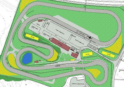

this last Wednesday i was supposed to go trackdriving at Sturup Raceway. (se picture of track)
But my broken diff -I´m having problems getting it apart - stopped me.
On the first of Octobre i´m going to Ring Knutstorp (se picture of track) just 12 kms south of me, for a whole day´s trackdriving with the Swedish honda Club.
My drift set-up is not that big in difference from the new track set-up.
