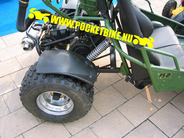

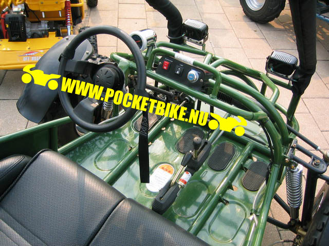

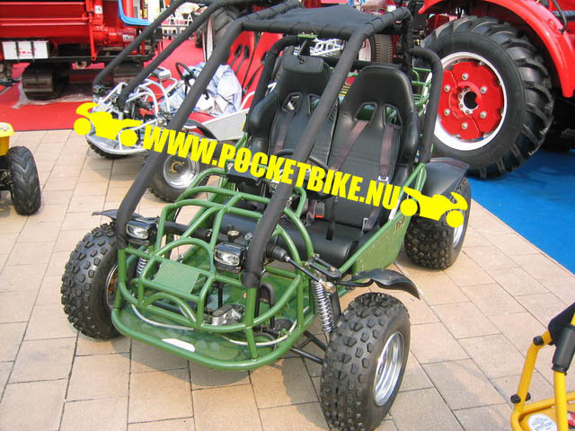

This is a BUGGY.
Chinamade
featurning an aircooled 150cc 4-stroke single cylinder enging with variomatic drive with reverse gear.
Topspeed of approx: 70-80 km/h
weight - 240 kgs
lenght - 220cm
width - 130
wheelbase - 160cm
Simply said:
Imagine this with an Honda CBR600 / 900 engine with 100 / 140 bhp @ 13000 rpm. Watercooled & 6-speed manual clutch (steering mounted)
This is my winter project -
the entire engine sits on the swingarm & therefor the swingarm will be lengthened to suit the motorcycle engine.
It is beeing build by me for a Swedish company that sells minicrosses & minimoto´s.
The finnished work ( the THING as it´s namned by me)
Will be on display at ELMIA. Next easter in Sweden.
Performance - will be in the region of:
0-100 in approx 4-5 seconds
topspeed in the low to mid 200´s - depending on gearing !
