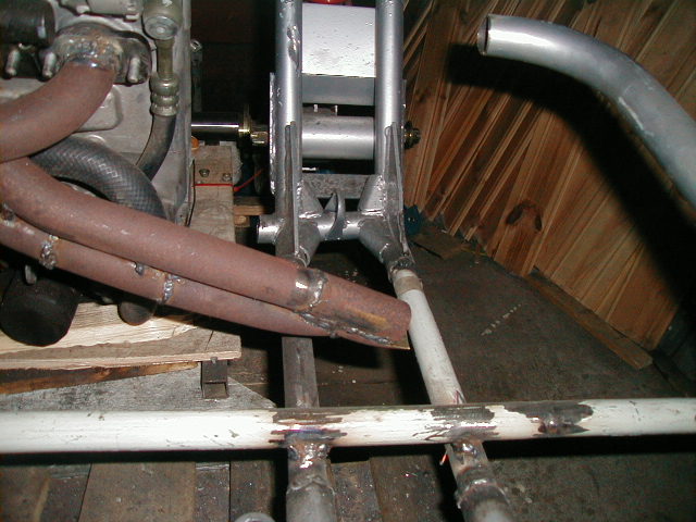

but the exhaust pipes will look good when you get some paint on them or something.
12-21-2005, 12:13 AM
Post: #32
Kris´s new winterproject !
legend Wrote:Im sorry to say this chris but the headers look like .............
Nice work tough really coming together nicely
all comments are welcome man Smile
just remember that the headers are not yet done totally.
Since the motor is stock - the headers dont need to be the exact same lenght.
They wont even be possible to be seen when the buggy is done .

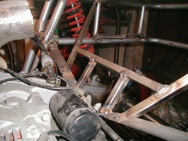

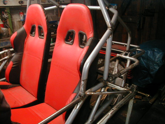

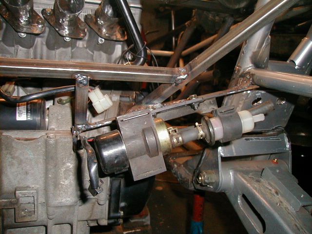

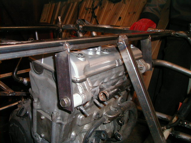

some more pics.....
Engine getting mounted tomorrow
02-07-2006, 02:13 AM
Post: #34

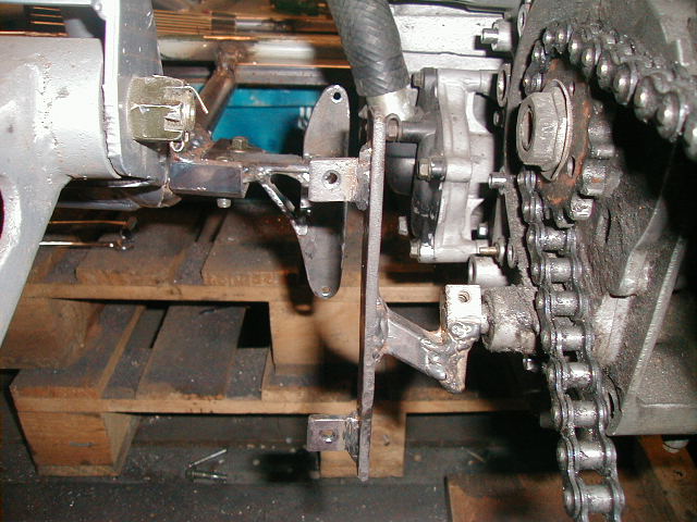

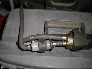

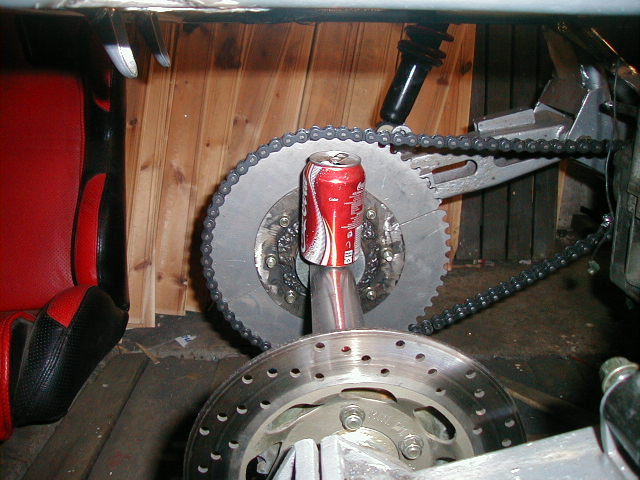

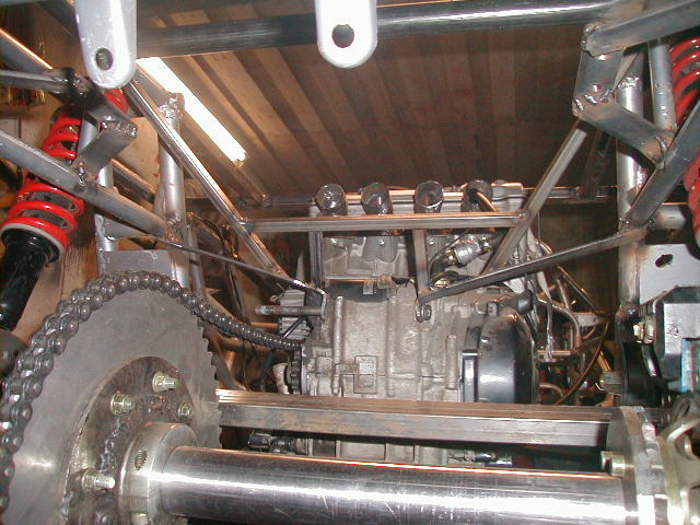

A few days ago we put the engine in place...
Also the fuelpump, enginemounts, rear axle, rear cogwheel... etc

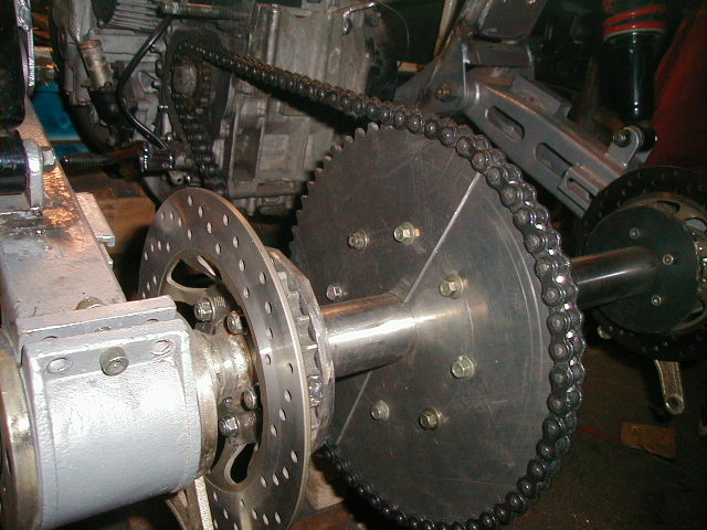

Dont forget a solid chain guard....you wouldnt want that thing to snap while your sitting in front of it without some protection.

Kris, do yourself a favour and put on a chain tensoiner. If you dont, i will guarentee you, that the chain comes of. And they always does that, when your having the most fun...
02-07-2006, 03:13 PM
Post: #38
Knudsen Wrote:Kris, do yourself a favour and put on a chain tensoiner. If you dont, i will guarentee you, that the chain comes of. And they always does that, when your having the most fun...
thanxs for the advice - i checked around for one - & i found a small frontsprocket style with a bearing in it.
The rear end is so still that iw only swings about 5cm total... så the need to a tensioner is quite small - but as you say Knudsen - it´s better to have one.
On the last picture - this kind of tensioner is fitted to an "hybrid" Take your time guessing Hurray!
k
02-07-2006, 05:09 PM
Post: #39
If you by: " The rear end is so still that iw only swings about 5cm total" means that the chain can bounce 5cm up/down, then a tensoiner is very nessesary!
Trust me Kris, i work with these things daily. If you allow the chain to bounce that much, it will either snap or jump of.
The tensioner you have posted a picture of, will indeed do the trick.
02-07-2006, 06:15 PM
Post: #40
Knudsen Wrote:If you by: " The rear end is so still that iw only swings about 5cm total" means that the chain can bounce 5cm up/down, then a tensoiner is very nessesary!
Well - i belive we missunderstood eachother Banging head Smile
What i did mean that the rear axle only swings by 5 cm - not the chain - the chain probably swings about 2-4 cm maximum -
(perhaps you remember that i too used to work as an Honda mechanic :wink: )
any guesses about the HYBRID in the picture then ?
