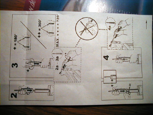

KONI YELLOW´s - fitting / adjusting info
11-25-2004, 02:03 AM
11-25-2004, 02:04 AM
part 2
11-25-2004, 09:21 AM
Damn,its hard to see detail on those scans, can you email me higher resolution?Smile
11-25-2004, 11:30 AM
mux213 Wrote:Damn,its hard to see detail on those scans, can you email me higher resolution?Smile
no email, put them up here! Smile
I want better res. too!
[Image: AEU86 AE86 - KONI YELLOW´s - fitting  / adjusting info]
