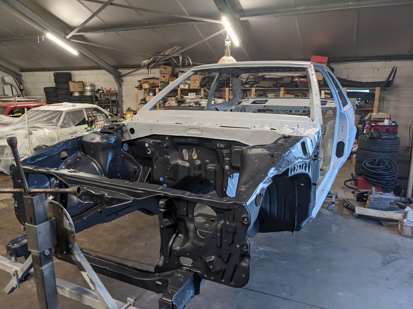

I just spent an afternoon masking and plugging the bottom of the car for undercoating. I used a box full of cheap ear plugs as bolt hole plugs and masking tape.
[Image: AEU86 AE86 - Ivan's coupe: bodywork is done]
Slapped some paper masking sheet to the sides
And as the more astute may have noticed: I slapped a can of the KH2 gunmetal grey on the bottom.
I was painting some small loose parts grey and then emptied what was left in the gun on the chassis. Then I got carried away and slapped the rest of the can on as well. Is this smart? No. The one upside is that I no longer have a patchwork of lightgrey/black to cover with undercoating, The downside is that I will have to scuff this up again(3rd time's the charm), and that it is a rather foolish way to waste 40 euro's worth of paint.

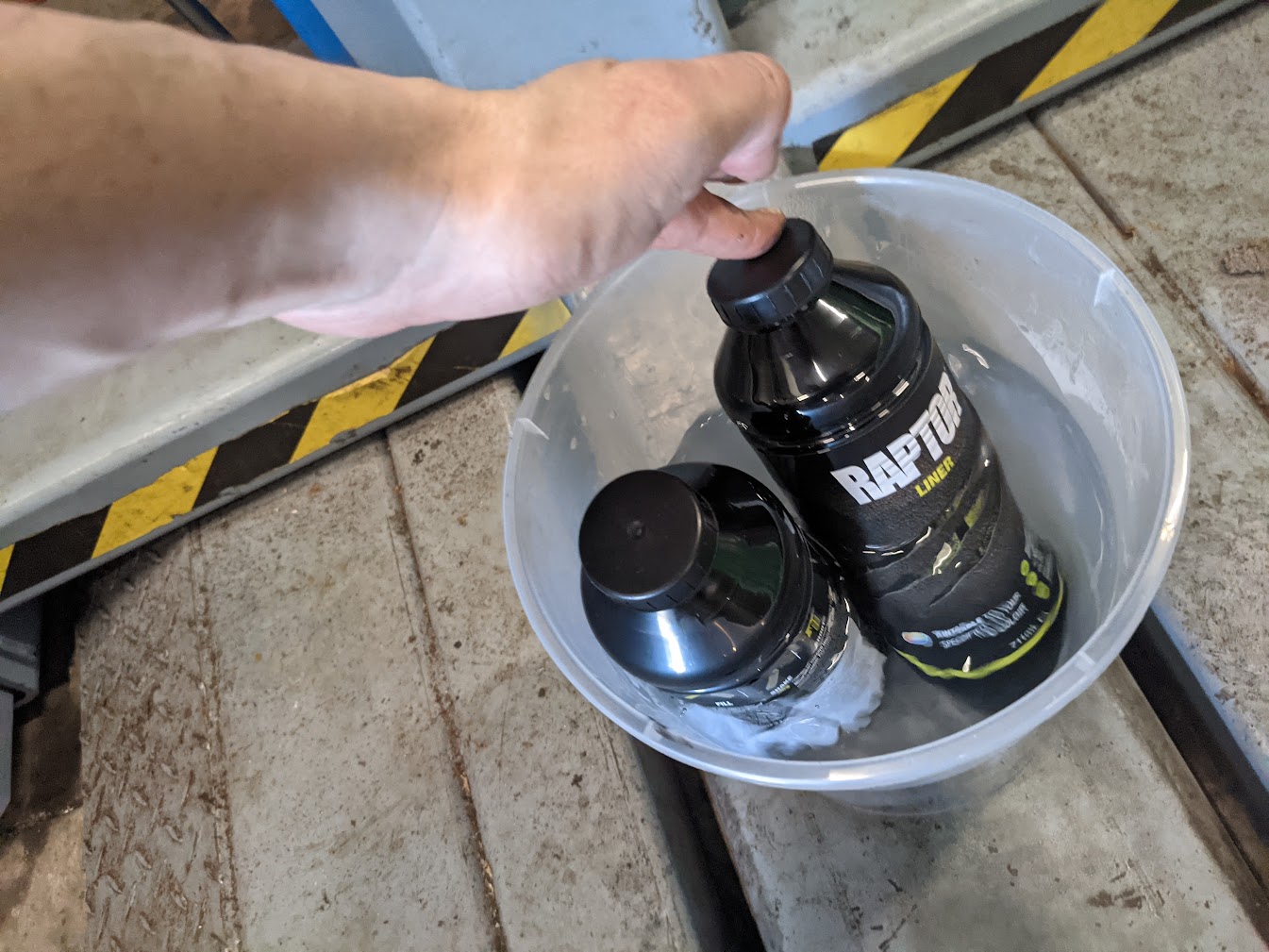

After complaining about the cold weather since basically christmas we finally got some warmer temperatures (only about a 30 deg.C rise in a week).
I decided to take the day off and make the pilgrimage to the shed to get some shipoopie done.
The raptor liner hadnt quite warmed up as much as the weather had, so I chucked the bottles in hot water to get the stuff a bit less gooey.
Health and safety advice kids: 2k products with isocyanate hardeners are potentially lethal, so protect yourself. I built this little contraption to supply me with breathable outside air. Basically a 1700W vacuum cleaner pump strapped to a HEPA filter, connected to a modified snorkelmask with a 3d printed adapter. This thing chooches away outside, far away from me and the polluted air.
