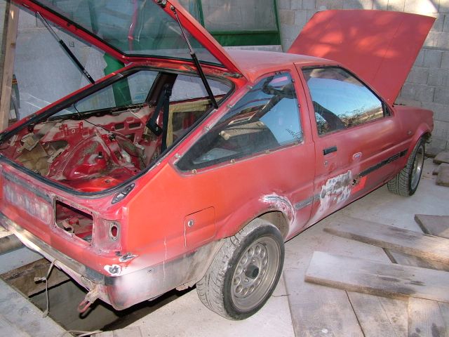

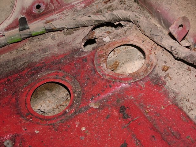

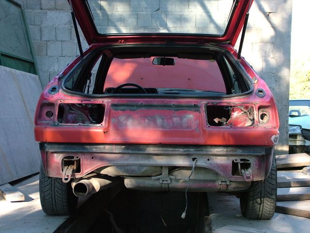

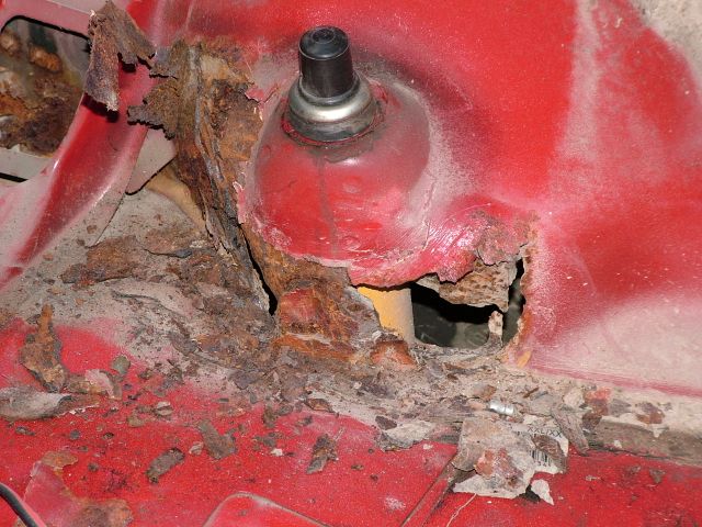

OK, here’s my bodywork plan in 3 steps:
Step 1: Striping out everything and locate rusty parts.
Step 2: Remove rust, weld reinforcement parts on body. In stand of putting roll cage inside, I’ll put reinforcement parts like I saw in AE86 Club vol.7
Step 3: Paintjob. Devil red Smile Still not sure about panda stripes?

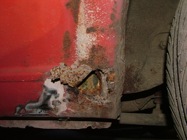

Sweet jezus...that rear shock mount is GONE! Blush Huh
Are you making the reinforcement parts yourself or are you getting the japanese stuff?

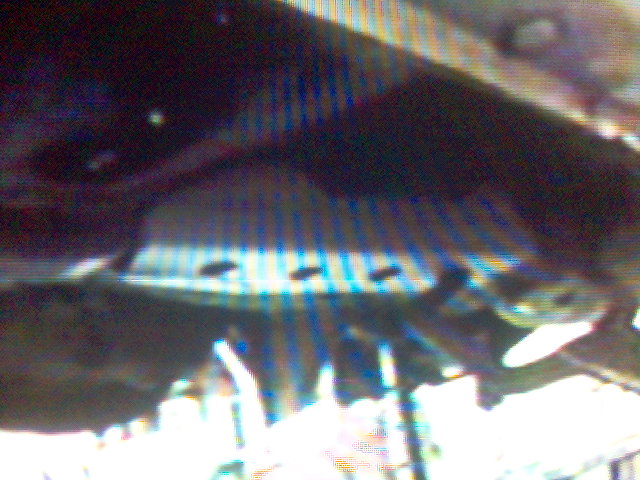

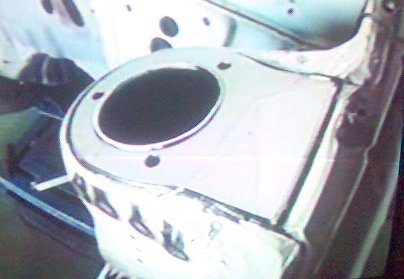

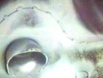

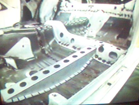

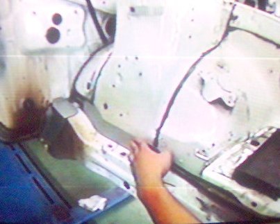

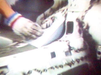

You can find full body rebuild and paint video in AE86 Club Vol.7. Here are some screen shots I took.
Fun is not the straight line!

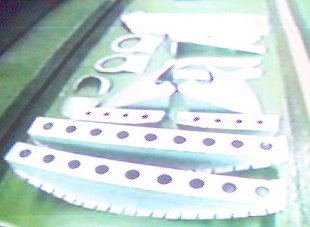

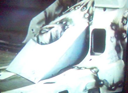

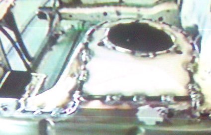

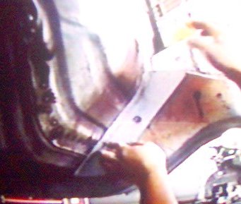

And few more...

Thank you very much for the pictures! They give a good idea on what points should be reinforced. It seems like one of these is the base of the front frame rails which also commonly flexes on KP6# Starlets and sometimes even gets torn off the firewall! Here's a good series of images on how this location is reinforced on the Starlet - I was thinking of a similar solution for my AE86;
http://users.tkk.fi/~mkolari/orangetoy/2002_03_28/
He has quite a lot of more photos of his project on the website (http://users.tkk.fi/~mkolari/orangetoy/) and since the FR Toyotas are all quite similar, a lot of the ideas shown there should apply also to AE86.
