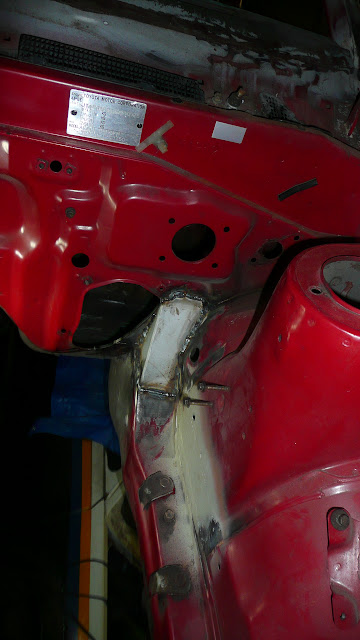

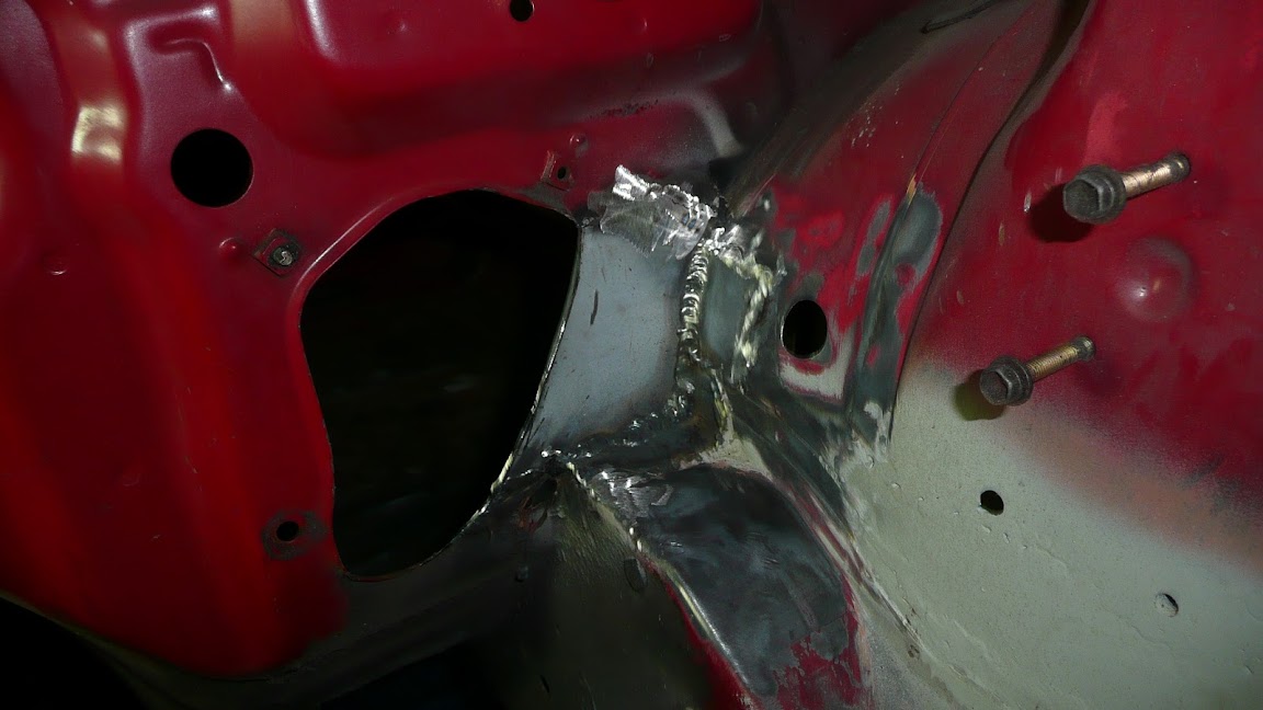

Here's something I posted last week, but got lost when the server crashed:
Last weeks holes have been patched up as best as I could.
[Image: AEU86 AE86 - Ivan's coupe: bodywork is done]
Cleaned up a bit, could have done a better job if my powerfile hadn't worn out.
Welded a gusset back in, ended up slightly chunky. Hope it wont get in the way of original parts too much (time will tell).

Almost done then? Yes, but I keep thinking up new crap to put off the next step in this resto. These spots are not pretty from close up, so I will do something about them.
Anyhoo, what remains for me to do is to make the best of the last few rusty spots, which probably includes redoing the other chassis to firewall gusset Bert made, just to make sure there is no shit underneath, and make it look like the one I did above.
