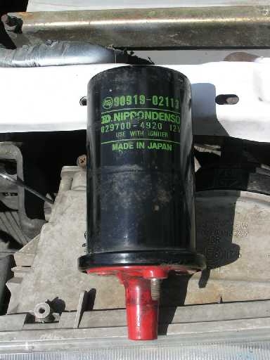

There is a simple cilindrical coil underneath the little aluminium igniter unit housing. They are just strapped together. So it's your basic coil with 2 small terminals with wires to the igniter and a single spark output to the distributor. The igniter has a few signal lines to the ECU. Dont have any usefull pictures handy, but I'm sure there are loads hidden deep inside the forum somewhere.

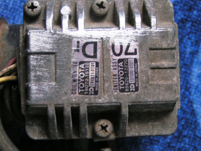

Have some more closeups if this one isnt helping you:

Ignition coil
Thanks
This is what i was searching for. Do you have a close up of those modules?
There are two arent they(or 2in1)?
[Image: AEU86 AE86 - Ignition coil]
05-23-2006, 02:56 PM
Ignition coil
There are two parts. The big one is the coil, the metal thing with the wires, attached to it is the igniter. You can buy them separately.
I guess you need the number of the igniter, thats why I just made a closeup of it. The coil I have pictured is probably hot the original one.

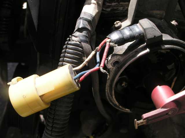

One more request, can you give me a close up of that jack/connector...

There are 3 pins in the connector. 3 are comming from the igniter, one is coming from the + of the coil.
I have the pictures, because I have problem with the igniter. Actually I bought the car like this - with different igniter with 6 wires, instead of 5.
Now I got an original one, that is waiting to be put in the car, thats why I have the pictures. You could buy a used igniter from ebay or you could check this auction, in case you are in Europe:
