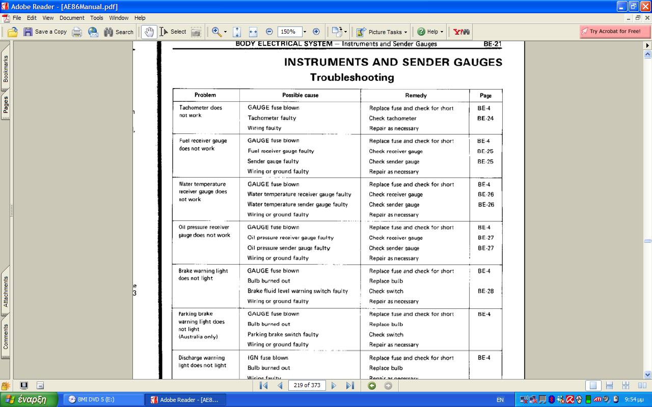

So you must check the whole line from the begining to the end something that i supose you have already done. Maybe a grounding or a wire gone faulty. Go to an electrician to have it checked for you man. I'm sending you a page from the electronic manual of the car that it shows the troubleshooting matrix. Maybe this could help you start backwards. Cheers!
09-04-2006, 01:10 PM
Post: #35
Hachi wont start.. anyone have a Grenade?
Thanks mate. I guess I just need to go back to square one.
