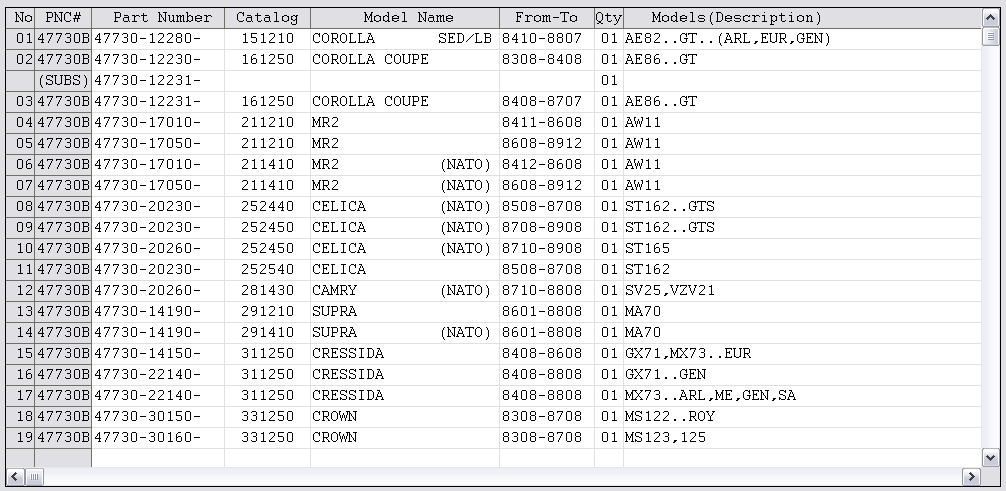

HELP ME. URGENT!
I had a look at the epc, looks like the mr2 ones are the same,
part number
47750A for the RH one
47730B for the LH one
th final part number is different because it adds the model code to it, but the exploded views are very similar,
on further investigation it looks like the fwd AE82 GT shares them as well
[Image: AEU86 AE86 - HELP ME. URGENT!]
06-13-2005, 09:41 PM
HELP ME. URGENT!
I worked out how to use the epc better, heres a screen dump of all matching vehicles for the same rear caliper assembly
*update*
tried some other parts including the halfshaft, and that listed both ae86 models so maybe the list below is not as good as i thought
06-13-2005, 09:56 PM
HELP ME. URGENT!
I just checked over at Fensport and looking at it, the AW11 does indeed have the same rear calipers (why I didnt check before I do not know Dumb question ) . I think this could help matters. Also I did try taking a picture of the rear assembly but alas my camera has no flash so at night I get rubbish pictures Banging head
