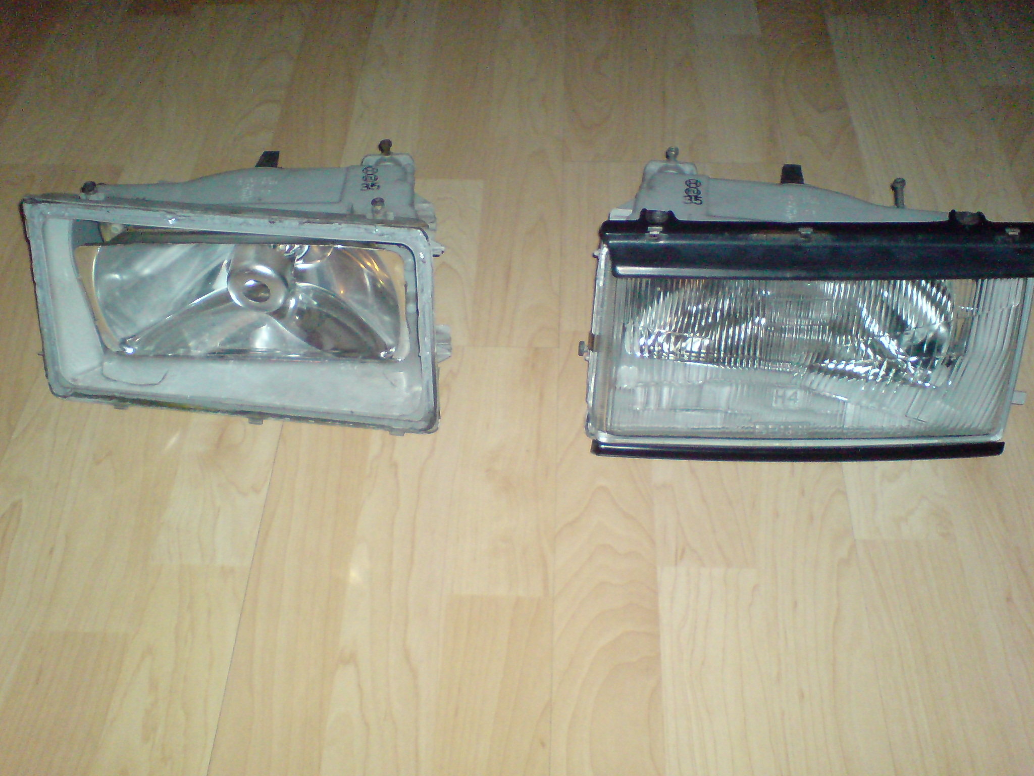

Had a little accident: http://www.aeu86.org/viewtopic/headlight-glass/t/5861
Got a spare headlight glass from Blackmane's zenki levin. Fits just fine! Gonna look for a EE80 glass tomorrow to finish the other one. Then straighten the bumper supports and it should be ready to roll again. ![]() PS. Banpei, about those bushings. I got an extra set of front and rear stabilizer bushings. But the rear ones are both of the same diameter. And they are both too BIG to fit tight around the bar. Do american AE86 have bigger rear stabilizer bars then? |
