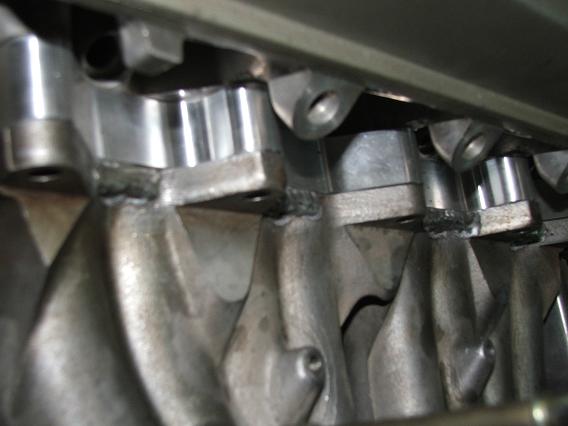

mo-racing: ZaX needed some pics of T-50 internals and replacing sychromesh. Intake manifold welding was done because at the welded points (between bolts) the T3 adapter was wider than the manifold and gasket, so there was a slight possibility of air escaping from there. Now, the welds have increased the width at those specific points, so the gasket and T3 adapter fit spot on.

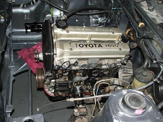

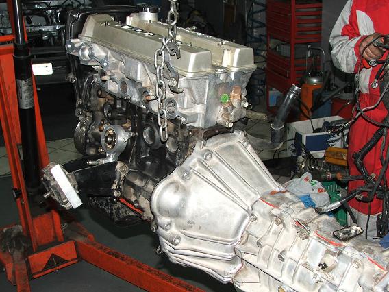

ALMOST THERE GUYS!
Engine and gearbox are in. Wire loom is NEW. New cables, custom made, only 2 cut wires.
You can see why the intake manifold was welded in the T3_adapter_InPlace picture. Now it fits perfectly.
Should drive off on Saturday afternoon, hopefully Thumbs up!

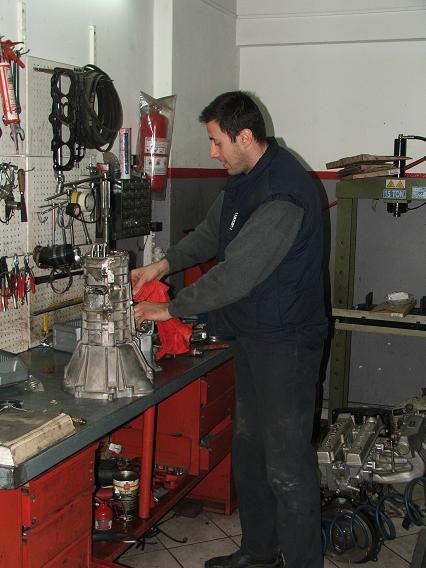

Here is Tasos the mechanic (tall guy!), assembling the gearbox and Vasilis the electrician working on the loom

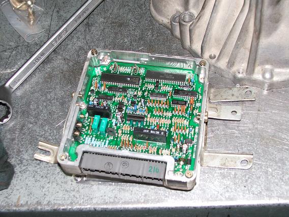

Nice. What did you do with ECU??
01-13-2005, 12:39 PM
Post: #47
Me? I didn't do anything with it Tongue
Seriously now, I prefer to leave the electronics stuff to the specialists. To answer your question, I don't know why he opened it, probably to check the circuitry.
