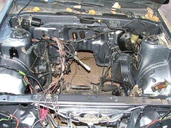

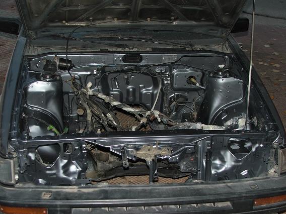

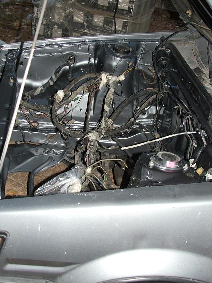

Now, back to business, I got the car back from the bodyshop and the engine bay looks NEW. The guy fixed the rust, cleaned up the oil and painted it. Cost 160 euro.
So my mate Mike (in the oven picture) towed me to the mechanic with his heroic 1.6 Tipo (Forza Italia). The engine is now almost complete. Only cam covers, pulleys and the new flywheel remain to be fitted. Also, the AE86 wire loom will have to be customised to fit, since the engine loom is from FF layout, thus shorter.

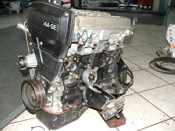

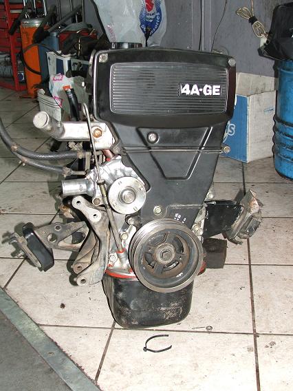

So, another update on my baby. Engine is finished except one little surprise I have for you guys. Purely cosmetic, but nice anyway.
The gearbox is rebuilt and sealed. ZaX, I didn't forget, but the mechanic fixed it last Thursday which is a holiday in Greece, so I didn't go over to take pics. He said he took some pics himself, so I'll see if I can get those for you.

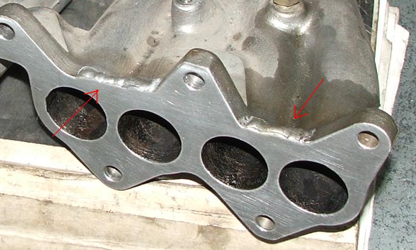

The bigport intake was welded between bolts to make shure no air escapes the gasket (see pic). The starter motor was also rebuilt and the injectors were cleaned.
The custom wire loom (AE86 car side, AE92 engine side) is in place as are the peripherals in the engine bay, so now we're waiting for the custom clutch to put everything together and into the car to connect to the loom.

2 dorito: welding intake manifold is good move.

one question. whats that manifold welding good for???

dont quite understand the welding of the manifold though.
