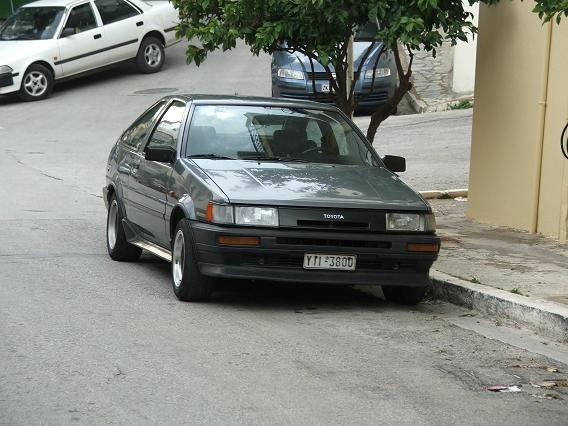

Thanks for the info and the wishes guys, but guess what...
See the passenger's door in the picture above? Looks nice huh?
Well I had a slight crash on a CLK last night (ice is very very slippery on my old worn tyres) and now the door and bodywork right behind it need fixing.
@nmwisima: now you see why I didn't paint the whole car.
Pics soon.
PS. I may sound very relaxed, but I'm just barely containing myself. The CLK guy called today to tell me that Mercedes want 1200-1400 euro total for the new bumper, silver lining, new parktronic sensor, paint and labour. And just because of a small crack. I hate Mercedes.
