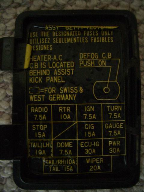

Hi Folks,
my car is missing a fusebox cover - and worst of all I keep blowing out the fuse for the instrument panel when drifting (weird?)
I've had a look in the workshop manual and I can't find any information on this fuse box (i.e. what sizes fuses and which fuse does what) only that of the master reset relay. I guess the fuse box is on the passenger side on european cars ?
Can anyone provide this info ? I need to make sure I'm using the correct fuses and stop of this blowing up - I went through 6 fuses yesterday.
Thanks in advance.
Regards Ian.

How weird that it's not in the manual. On euro spec cars the fusebox is also located on the left side of the car (the ECU is on the righthand side).
My guess is that you have a loose wire somewhere that shorts out to something while drifting..You could try to see what colour the wire's leading to the fuse have, that way you could look up probable suspects using the wiring diagrams.

Here you go my friend, hope this is readable.
