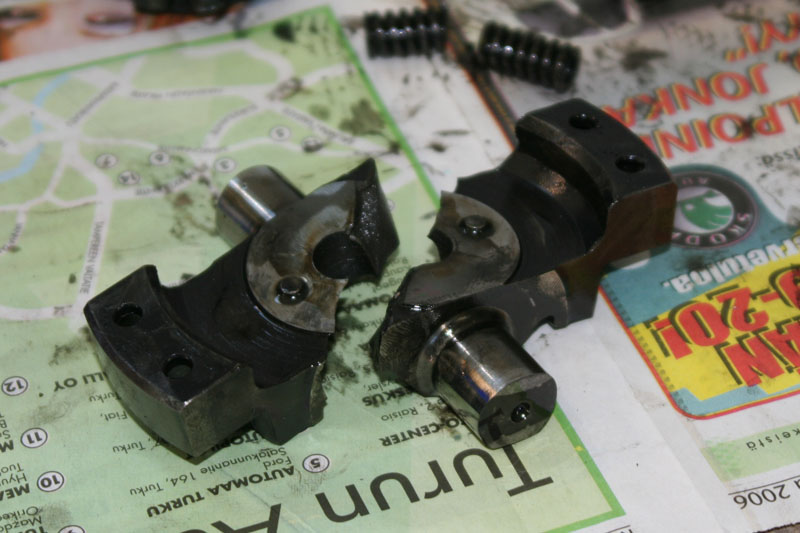

Ok, I got the diff now disassembled and found some pretty nasty carnage inside. The clutch block with the two gears was split in half, the other block had cracked from its corners and two of the four springs were split. The casing is still intact, as are all four gears. I have no idea what those two clutch blocks cost as OEM spares so I'm a bit worried whether it would actually be cheaper to get a completely new stock kouki LSD instead of buying spare parts to fix the current one...
06-25-2006, 12:44 PM
Post: #40
Firehawk's N2 racecar project
Bad news Angry
Check the price of those parts... Blush
I thinck it's the first thing to do... :wink:
Good luck with the rest Wave
