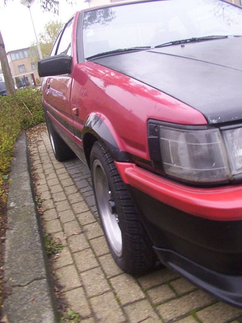

Now I REALLY need to get rid of that pesky lip. I'ma buy myself some fender flares or new fenders because the revolotion wheels are really coming close to the fenders. I have less trouble with sharp turns than I had before with the 195/60r14 tires, but long corners at fast speeds are now also a problem....weird. I might just grind off the front fender lip altogether. Rolling is more trouble, whilst cutting provides a little bit more space for the tires.

Yeah I know. I dont like the mounting method used for most fibreglass flares. You have to screw those on top, which is likely to rust. If I put fibreglass front fenders on then I would mold in wider flares for sure. The rear is not causing me any problems yet luckily.
For the moment I'm going with more springrate and rolled lip up front.
Here's a pic so you have an idea how far out the revolutions come:
