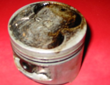

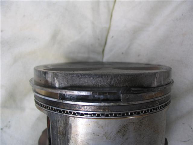

Ok, here's what I've concluded on;
- The 9.4:1 piston has a slightly dished crown (increases the CC volume by 1.6cc).
- The 10.0:1 piston has a similarly domed crown (decreases the CC volume by 1.6cc)
- The 10.3:1 redtop piston has a similar crown to the european bluetop one, but with a slightly higher dome (decreases the CC volume by 3.0cc)
Below are some photos for illustration - you can clearly see the difference between the 10.x:1 ones and 9.4:1 ones because the centre of the piston's crown is actually recessed below the rim of the crown.

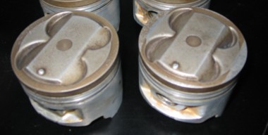

Photo nr 3 is mine.. came out of my first engine (275.000 km).
I still have those here in my room.

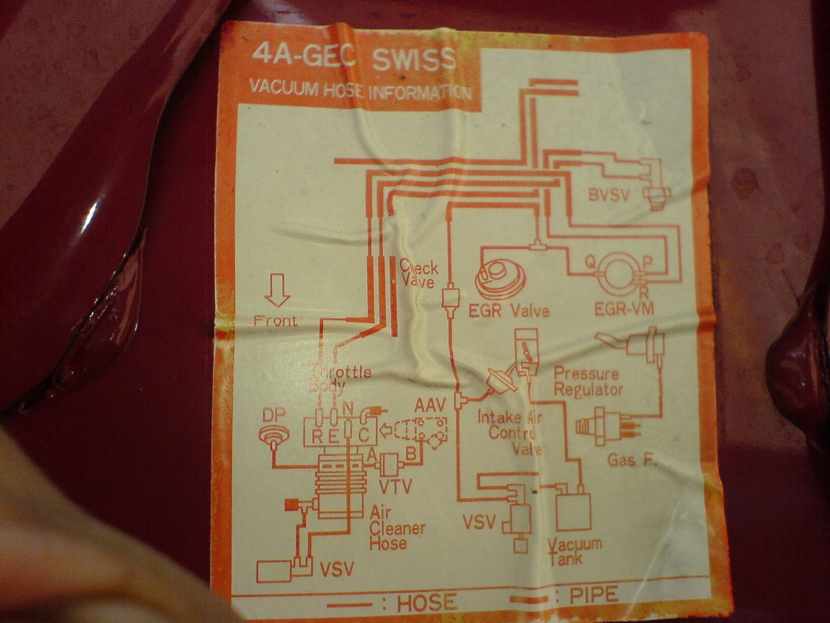

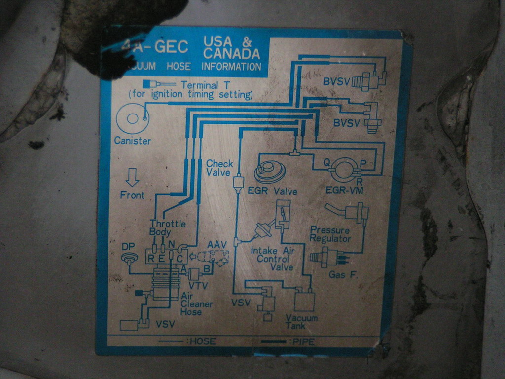

If helps I'm posting the two vacuum hoose information. The red one is Swiss 4AGEC (tnx to Ryo Smile), the blue one (found on club4ag) is USA 4AGEC vacum hoose information:
Regards
Andrej
