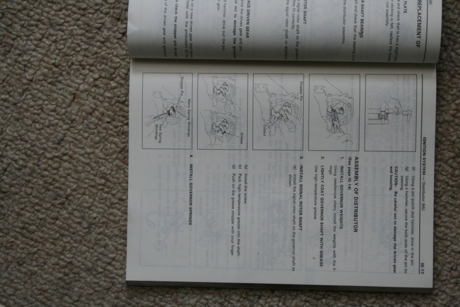

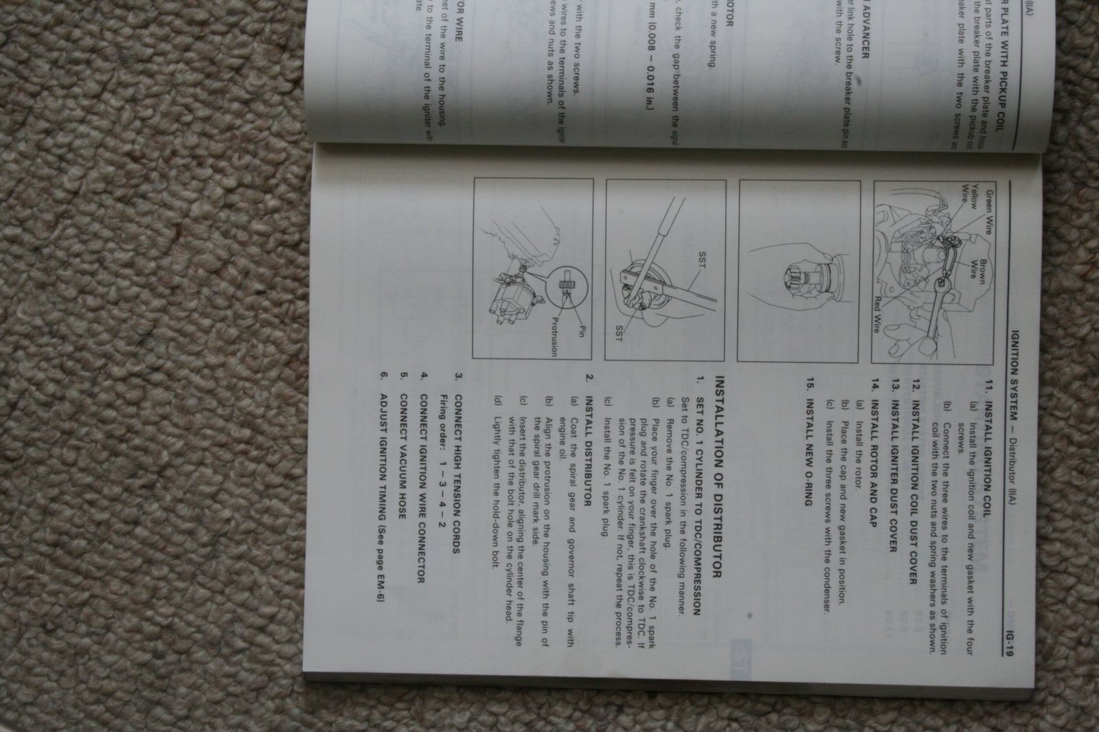

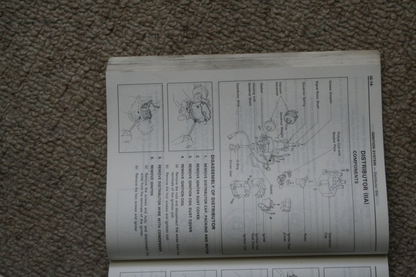

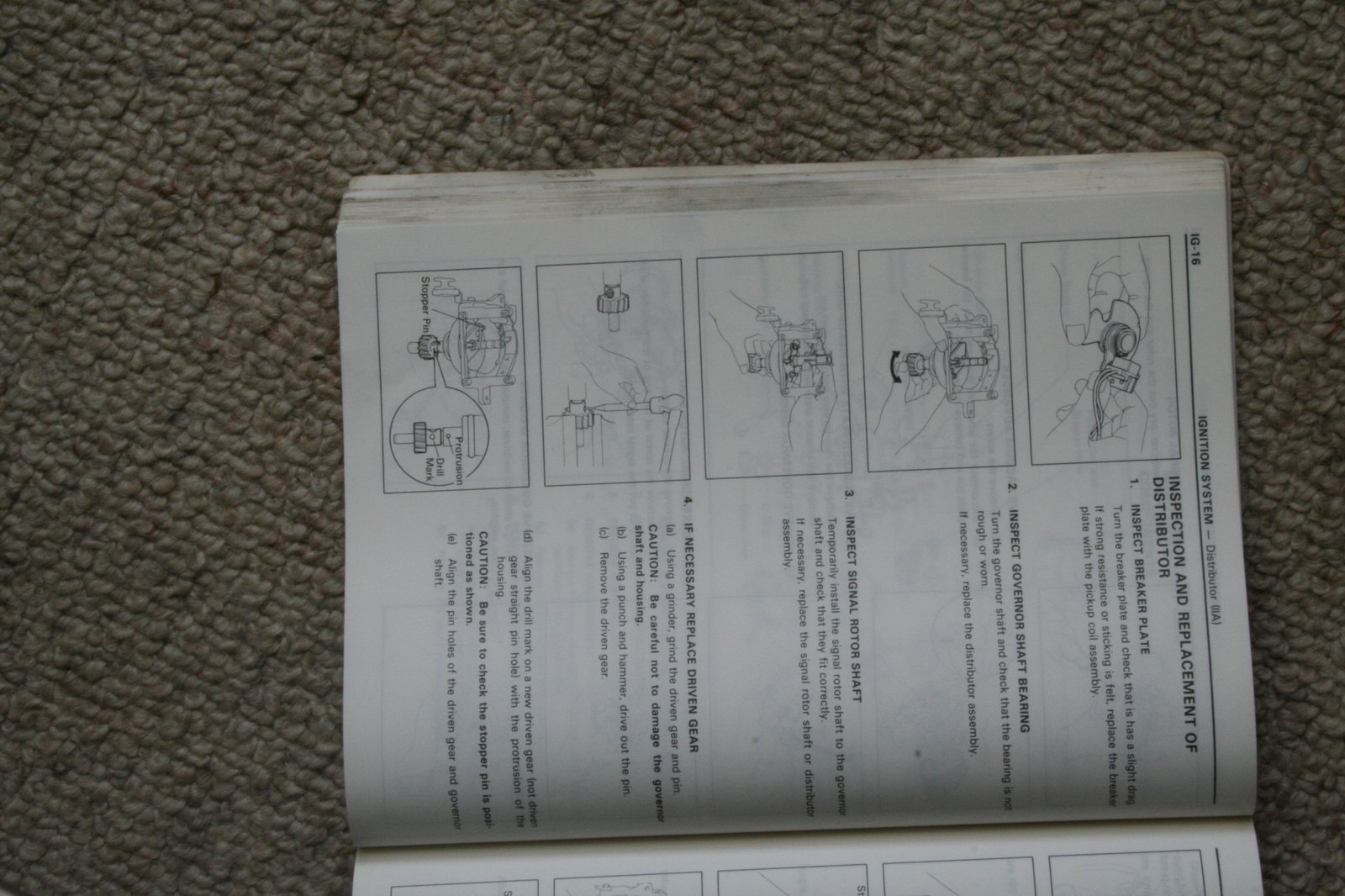

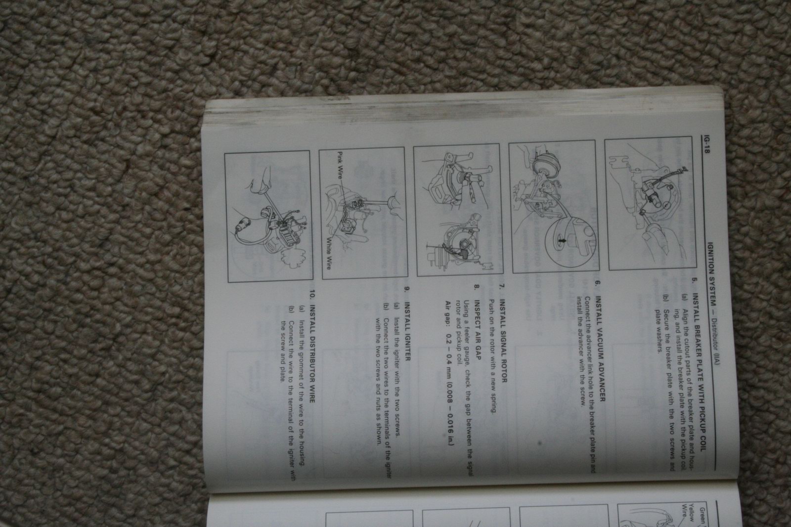

I have the 4A engine book (also features the 4ac) but I don't know when I have time to scan/photograph the right pages. May take a few days.

i would much appriciated it, it should only be 1 or 2 pages should it not ? my distributer has the internal coil, and ignitor ? im missing this little ignitor thing and theres like 6 wires i donno where they go to haha, anyway if you have time and can scan those it would be much appriciated Big Grin
thanks in advance
anmd i scanned through the 4age manual and it only has the rmeote coil distros Sad

In total there are six pages. I hope the pictures are clear enough, otherwise I can always make new ones. Wink
If you need them in a higher resolution just say so: I resized them all to smaller pics.
