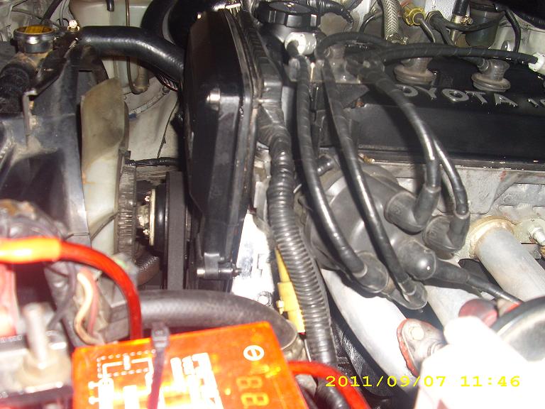

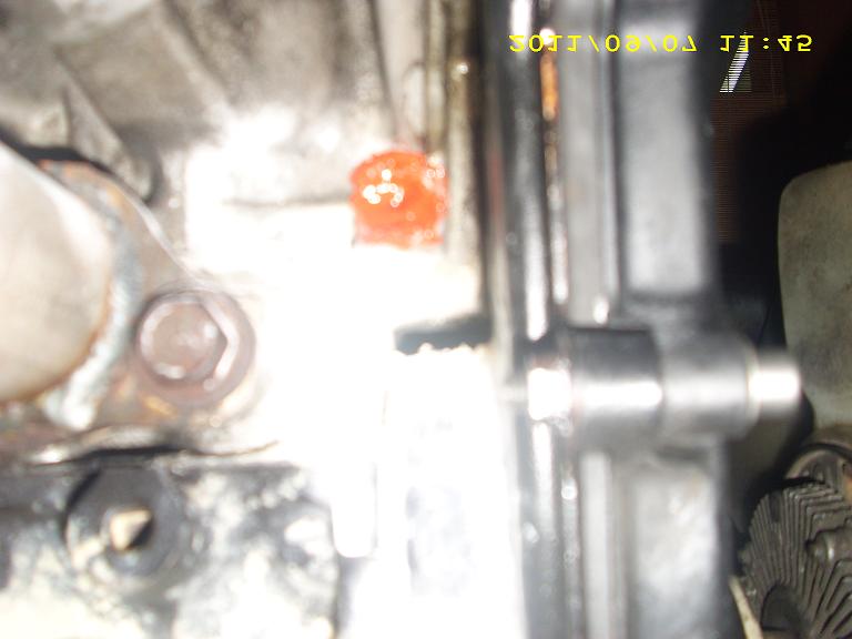

after enjoy the leak free day, suddently found leak more serious at distributer side. after use the talcum power check method, found the oil leak from HEAD part (as per photo circle). currently still uable do any thing on it, wonder what the function of this hole? and another question is when i done repair this leak, what about the high pressure? please do help. thank you

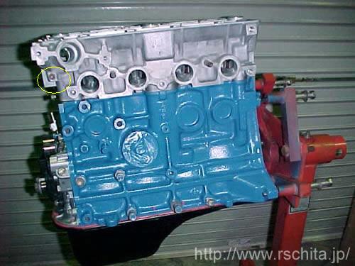

Regarding the plug arrowed in the pictures... I believe it is a threaded
plug used to close a drilled oil gallery. It appears to to be connected to
the gallery that carries oil to the camshafts.
Perhaps someone can confirm ??
Cheers... jondee86
09-12-2011, 07:41 PM
Oil Leakage from Head (near distributer)
Yeap it´s an unused oil gallery, take the headles allen key bolt out and seal it with teflon tape.

thanks guys, i have take out the "NUT" and again add in silicone gasket to total seal the hole. it did work, now again leakage. this time is behind the timing gear cover. i think i hav to open the whole "head" for inspection.
