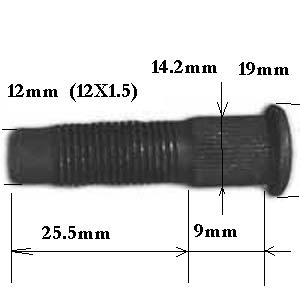

Just discovered that one of my rear wheel studs broke off, causing rattling sounds while driving. One half of the stud is still in the hub/brakedisc. Can I just remove it by tapping it out from the front?
Okay but my reallll question was...what are the dimensions of the wheel stud?? couldnt find it... (I have standard 14" pizzacutters, if relevant)

I have front wheel stud on my desk now.

so 25.5 mms protrude out from the hub? If one bought 25 mm spacers with 4x100 studs, would this spacer acomondatte for the studs to be bolted down/hidden?

Yes, Apolan. That's why I always recommend 25+mm thick wheel adapters.
In fact sometimes 20mm ones can work also.

Thanks for picture Jamiemirror! Smile
