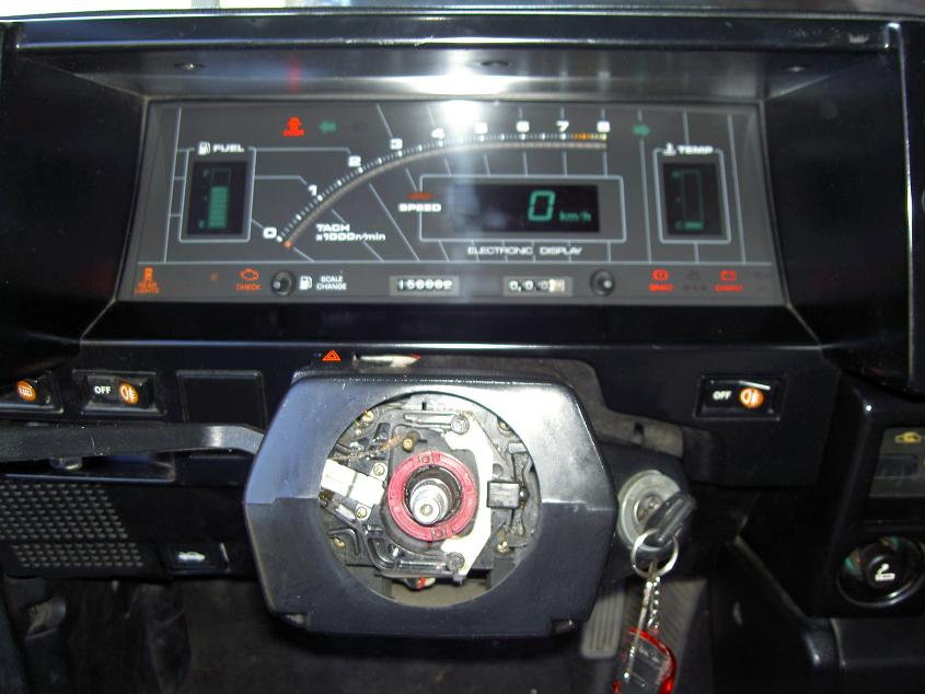

I got my digi cluster working
I used the exel file but it was for a rhd hachi
and some wire colors dont match for the lhd or maybe
becausse i have a kouki car and the digi clusters are zenki's?
for the oil sender i used first one of a 4a-fe engine but to be sure
i used one of a sw20 and the reading of the sender stays the same on the
multimeter
here's a pic of it
