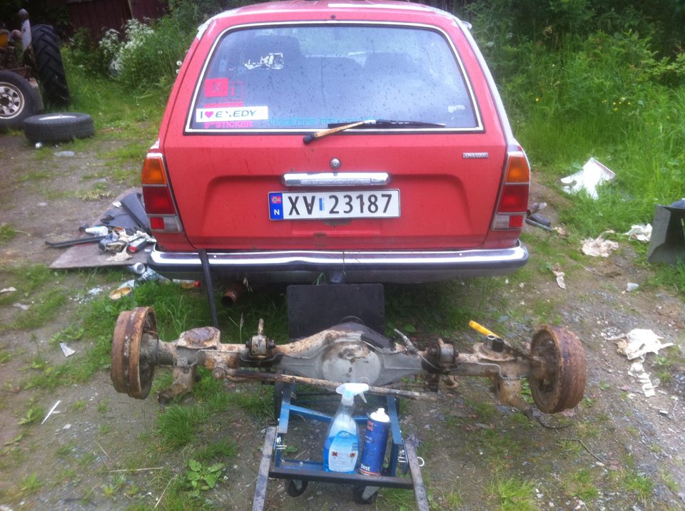

Picked up some parts yesterday.
The width might be an issue, but was going to put flares on anyway Tongue
The leaf spring spacing is around 1000mm, and the lower link spacing on the axle is also around 1000mm, so can use the leaf spring brackets up front for bottom link mounts.
