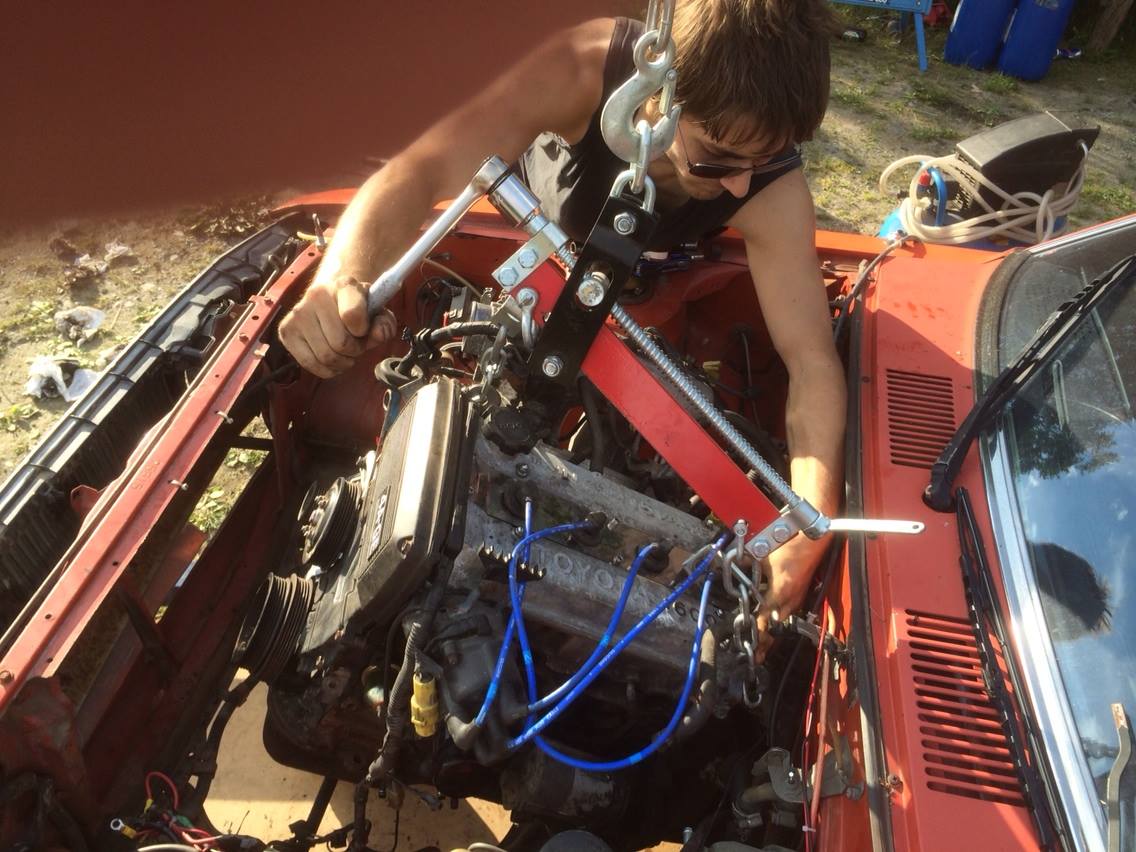

07-26-2014, 01:18 AM
(This post was last modified: 07-26-2014 01:19 AM by Rascal21.)
Post: #57
DIY: Hopeless project.
Progress earlier today, after coming home from a dinner party I got the engine&tranny in the car with transmission mounted on chassis, not entirely sure but I could have sworn I`m the first in the world to slap a 4AGE into a TA40. Because if people had seen what I`m seeing (Will update with pic later on) they`d regret tossing the old TA40`s away like candy, this chassis has potential!! Starting to rethink future plans for this car.. 1x AE86 84` Zenki Coupè Levin 4A-GE 20v 1x AE86 83' Zenki Coupe Levin 4A-GE 16v 1x TA60 82' Sedan 2T 8V 1x TA40 78` MK1 Zenk/Pre-Facelift Wagon 4A-GE 16v |
07-28-2014, 12:07 AM
(This post was last modified: 07-28-2014 12:57 AM by Rascal21.)
Post: #58
If I knew the engine was going to be placed this far back on TA40`s I should have just bought the two the previous owner of this one had, instead of just one! The silly part is that the 4AGE mounts line up some 6,5-7cm further back than the 2T. And since the 2T block is wider than the 4AGE, the mounts have to be longer as well, this poses a problem on the passenger side mount because the alternator gets in the way considering the 90 degree engine mount fabrication rule. But other than that the swap was a breeze, this car already had a TA60 gearbox and driveshaft, so I took a EDM AE86 bellhousing (JDM can also be used, but it has clutch slave on our driver side so youd need an AE82 slave) and bolted it to the TA60 transmission, this way the shifter lines up with the OEM shifter placement I know the AE86 gearbox has a better input shaft bearing, so will simply have to make do with the TA60 gearbox until I can find a AE86 gearbox to swap the TA60 bellhousing and tailgate+mechanism over. 1x AE86 84` Zenki Coupè Levin 4A-GE 20v 1x AE86 83' Zenki Coupe Levin 4A-GE 16v 1x TA60 82' Sedan 2T 8V 1x TA40 78` MK1 Zenk/Pre-Facelift Wagon 4A-GE 16v |
