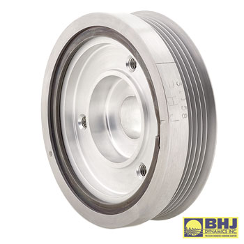

(05-07-2014 07:45 PM)Bean Bandit Wrote:
(05-07-2014 06:15 PM)oldeskewltoy Wrote:  [Image: AEU86 AE86 - Crank pulley without harmonic damper]
must resist Angel
Rotational mass reduction is a good thing...
JMHO..... [Image: AEU86 AE86 - Crank pulley without harmonic damper]
BUT... when it comes to the damper, I'd say this is the last bit you need to concern yourself with. The difference between a stock one and this is so minimal. Its convenience/ease to change is what makes it "desirable"... but in reality...
reciprocating mass is FAR more important to make light weight, followed by the clutch/flywheel assembly. ONLY after all those have been addressed should a light weight crank pulley be considered....
Dan -
05-07-2014, 08:39 PM
You're not helping Wink I have changed everything else and went great lengths in the weight reduction road with my internals.
Oh well, maybe something for next month or the one after.
Anyone up for a group-buy?

Bean I might be up for it if we can get a good price Wink Anybody else?

http://www.mrpltd.co.nz/browse/118_250/h...ncers.html
[Image: AEU86 AE86 - Crank pulley without harmonic damper];[Image: AEU86 AE86 - Crank pulley without harmonic damper]
Cheers... jondee86
05-18-2014, 09:43 AM
(05-18-2014 12:35 AM)jondee86 Wrote:  http://www.mrpltd.co.nz/browse/118_250/h...ncers.html
Cheers... jondee86
That's the same as Dan posted just more expensive Wink
AE86 ex-daily
05-18-2014, 11:13 AM
Manon is in New Zealand so the price is in NZ$ not in US$
479nzd ~= 400usd, so ~8usd more than directly from BHJ -> for peoples who live in the "other side of the world" it's quite interesting if you consider the shipping.
05-18-2014, 12:02 PM
Hahahahah.... my bad !! I never looked too closely at the pics...
just thought it was a different pulley lying down. Actually, I thought
it was a Nevo pulley from Australia, but apparently they are not in
that business any more. Oh well.... these guys make one...
http://rossperformanceparts.com/mj_race_...cers.html#
But I have no idea of the pricing... more I would guess.
Cheers... jondee86

The other (best) option if you have $600 to spend: Custom ATI Super Damper
http://www.atiracing.com/pdf/custom-damper-form.pdf
05-18-2014, 05:36 PM
The Ross Tuffbond is more than US$600 think closer to 700 even.
I sent BHJ and eMail and asked if they would consider a discount for a group buy... so we'll see what they answer in a few days.
ATI is interesting but at min of 600, rather unlikely considering this only applies if they can use a majority of of the shelf components, makes it again rather expensive unless you can order 10+ pieces.
