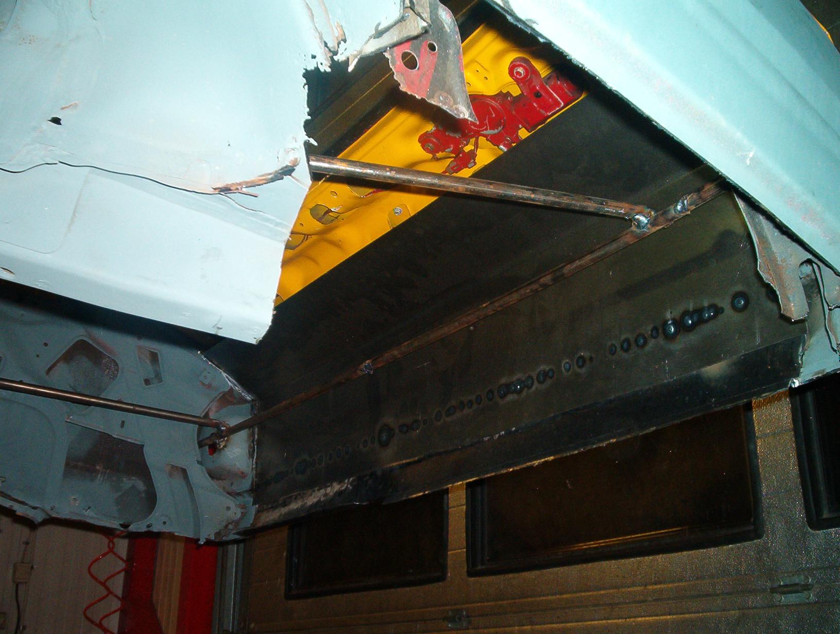

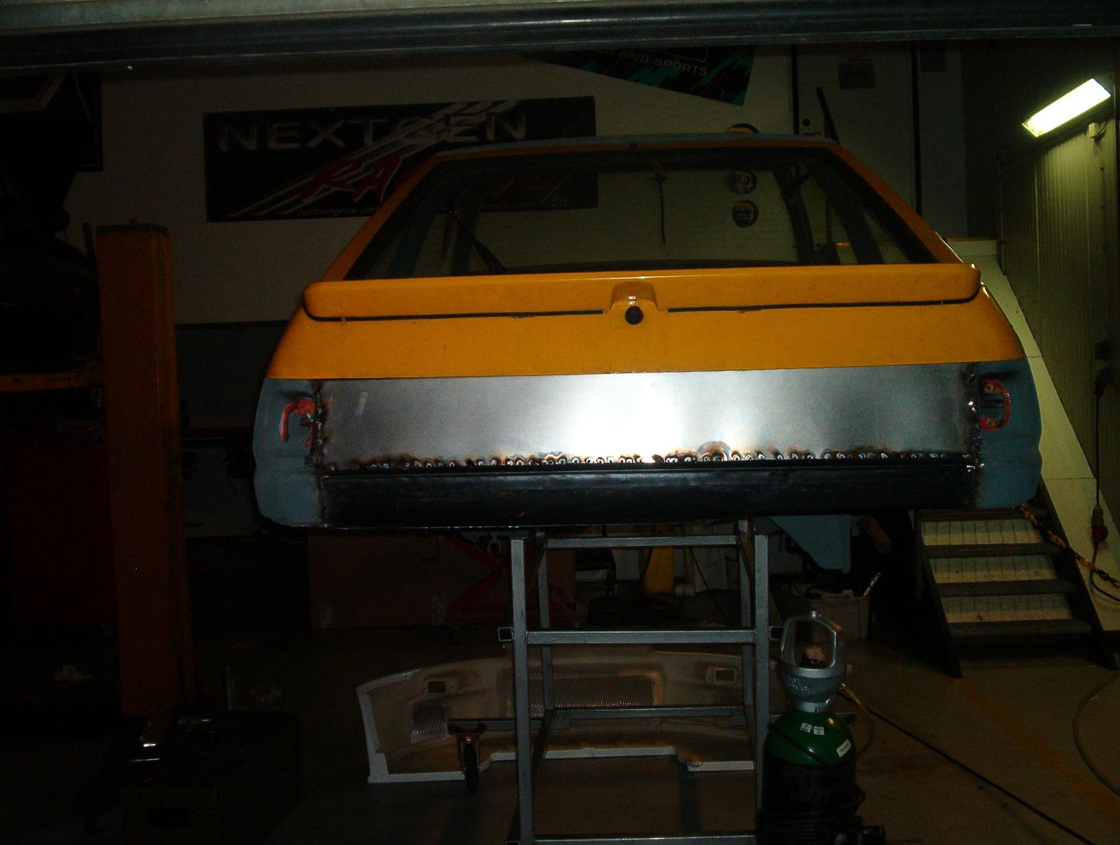

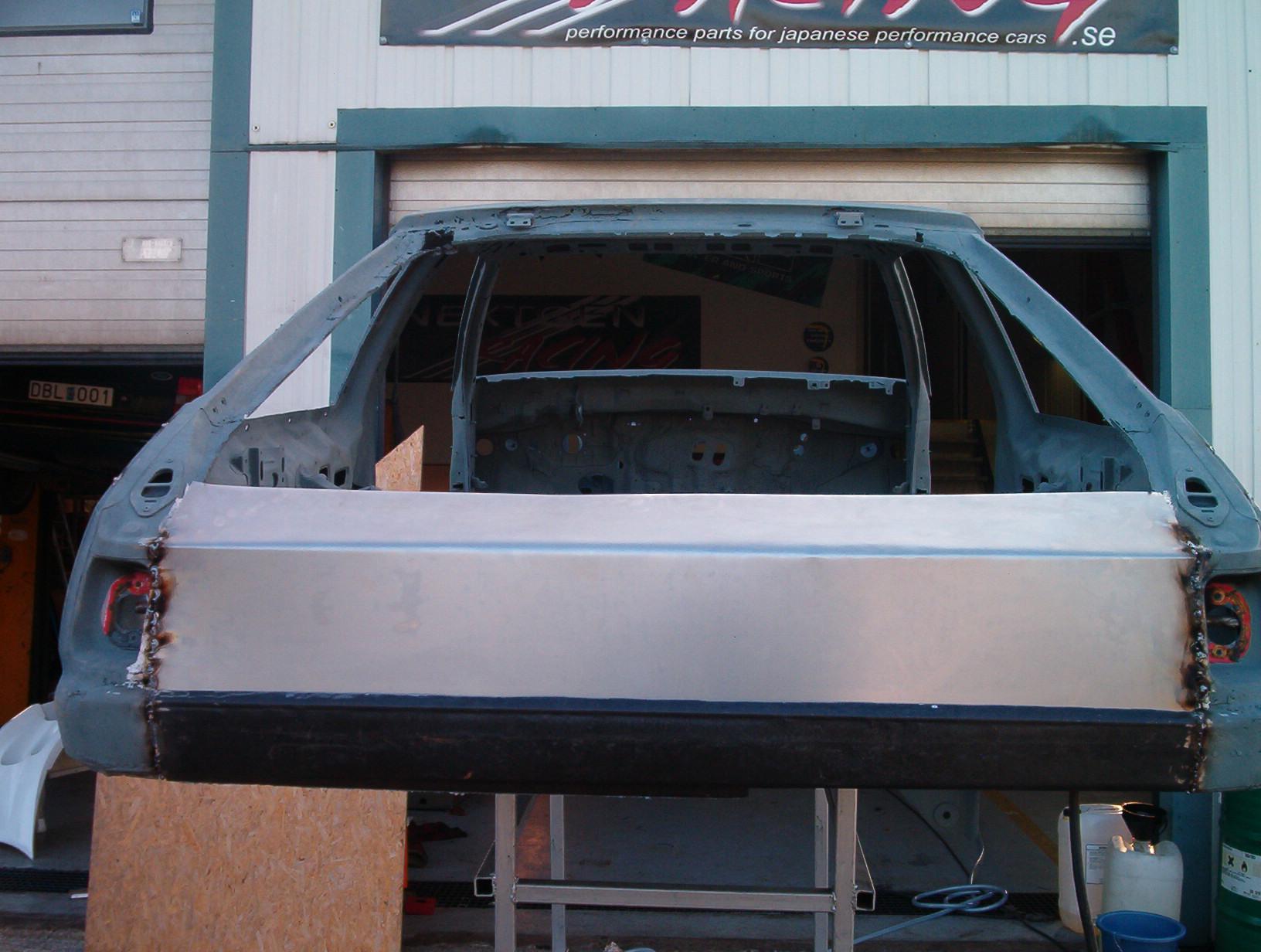

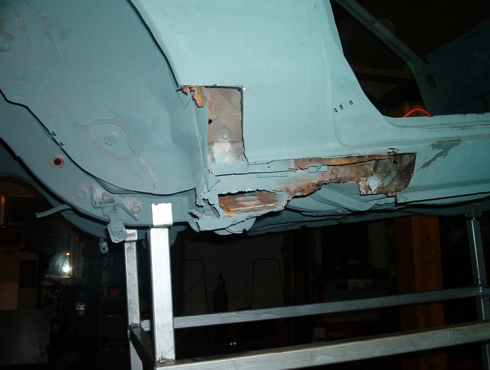

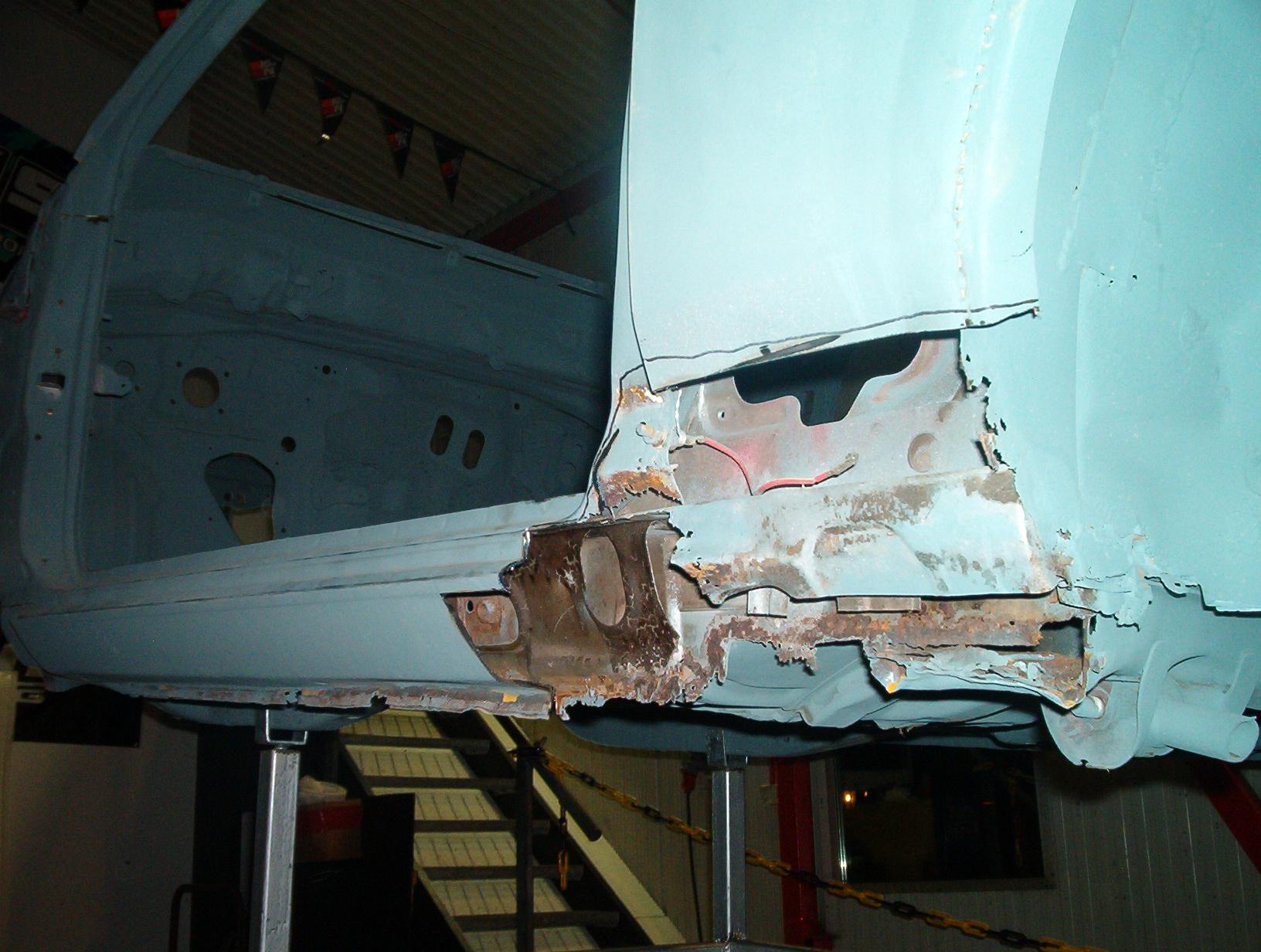

new pics, i am not done jet but i am on the way

Are you planning on remaking your rear lights...? Dumb question
If not.. i do like that smooth look on the rear.
Looking good thou! Keep it up!
07-29-2005, 09:13 AM
Post: #46
this is just the begining it is not going to be this flat when i am done.
best regards daniel

Hey Daniel,
How are you going to treat the inside of the side seals? Now that you've cut away there you can clearly see its very rusty inside of them and thats something that you can't normally reach with sandblasting...
Anyways, I'm amazed at the work your doing, keep those pictures coming, way cool work!

Post: #49
the rear end is coing to be totaly rebuilt and designd more for drifftinf and my needs. rust eater is going to be used in these places.
