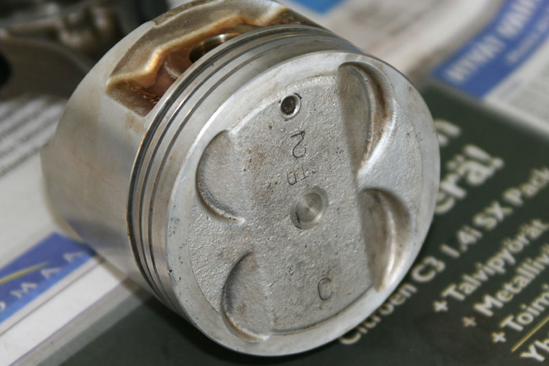

Here's a photo I took today of the 10.0:1 pistons in my AE86. If you compare it to the photo of the 9.4:1 pistons I posted earlier, you can see how the dome on these is almost like a "mirror image" of the dish in the 9.4:1 ones.
BTW, ís there any difference in factory reported maximum torque between the two engines?

this picture above of the 10.0:1 piston shows that they are very similar to the RED top 10.3:1 pistons, which have the dot on the side, (showing in which position the piston should be placed in the cylinder) sticking up as the highest point of the piston, while the one on the pic is actually a little hole... also the dome seems a bit lower compared to the RED top, at least from what I can see on the picture. The RED top are also ceramic coated on top, just like the GZE pistons, while the one on the pic is not! also would be interesting to se if the Blue top had 1.5,1.5,2.8mm thick rings, or 1.2,1.5,2.8 rings as the RED top?
aghhhh.... go figure.... Banging head Hurray!
