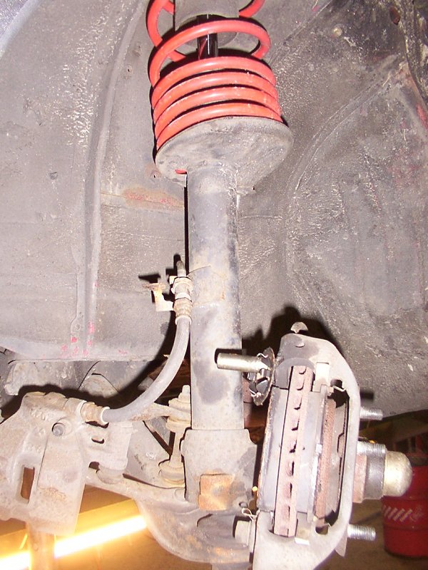

Yesterday I started work on the bushings for my hachi at Lennert's place.
We first raised the front up on the bridge and supported the cross member with an axle stand.
Since I was going to try some stiffer springs out on the front, we took out the entire front struts to begin with. Since there are control arm bushings in the prothane kit this is also the way to go if your going to install those, we forgot to do these, they are probably also the hardest to take dissasemble.
01-05-2005, 09:32 PM
Bushings!:)

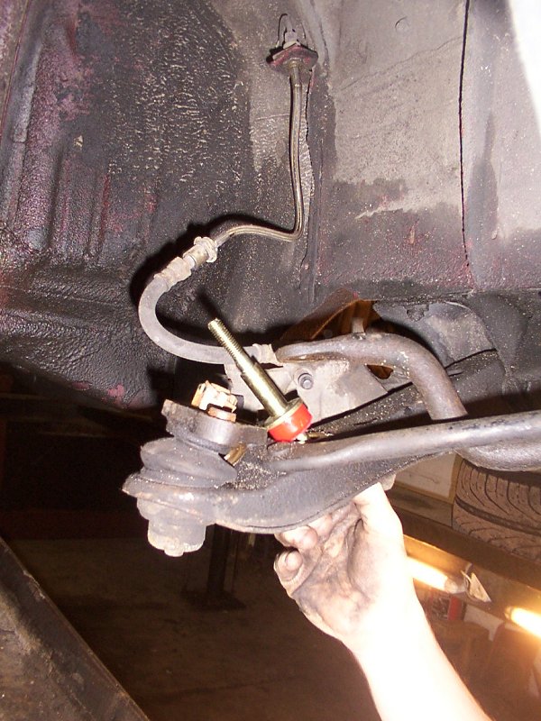

After mounting the new springs we started work on the front stabiliser bushings.
We started with new end links, as these are pretty easy to replace, especially when you have a mate helping you out. Just put a 10 or 12 wrench on the flat bit in the center of the end link and start undoing those nuts on the top and bottom. Once you're done with that it is easier to undo them on the other side as well so you can move the stabiliser bar up without trouble.
The new end links come complete from prothane, you just put them on in the correct order and start fastening the nut onto the bolt. Be very carefull not too get carried away with tightening the nuts on these ones, cause you'll just squash the poly bushes if you go to far.
here's a pic of halfway the assembly, and the finished product.
