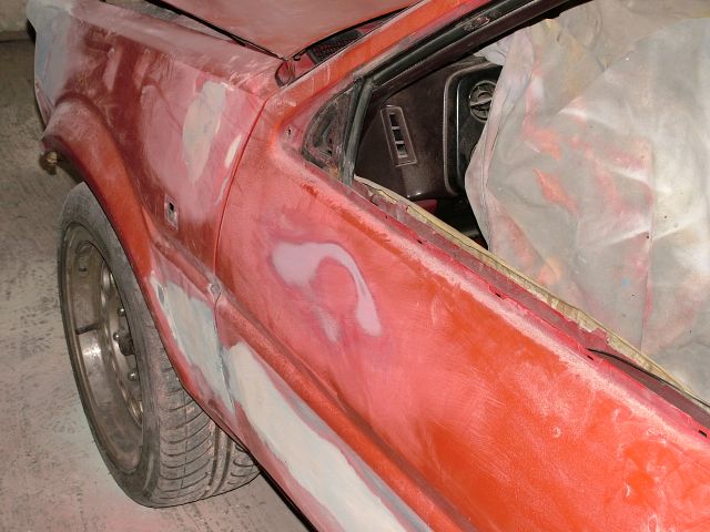

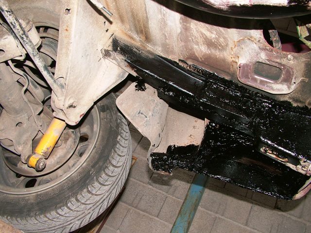

Ivan141 Wrote:I have exactly the same rust problem there...only worse I think it is not a big problem to fix. Cut the rusty part out, and weld a strong plate back in. I’ll take a few pictures of it when we will fix it. Fun is not the straight line! |

great work! while your at it, you might wanna get him to weld in some reinforcements perhaps?

Apolan Wrote:great work! while your at it, you might wanna get him to weld in some reinforcements perhaps? Welding around struts are also great part of reinforcement job, because stock car has very poor plates connections on this parts, mostly pressed and fixed with special glue with only few welding points. I still have to put front strut bar to connect struts to stiff front end. About reinforcement under seats, I’m not sure what to do because for now I’ll keep stock springs and there is no need for extra kilograms. Fun is not the straight line! |

Wheels are back, rusty part under fuel tank has been replaced and fuel tank is ready to be plugged in. I’ll try to start the engine tomorrow to check my new fuel pump. I’ll also replace old fuel hoses. Fun is not the straight line! |
