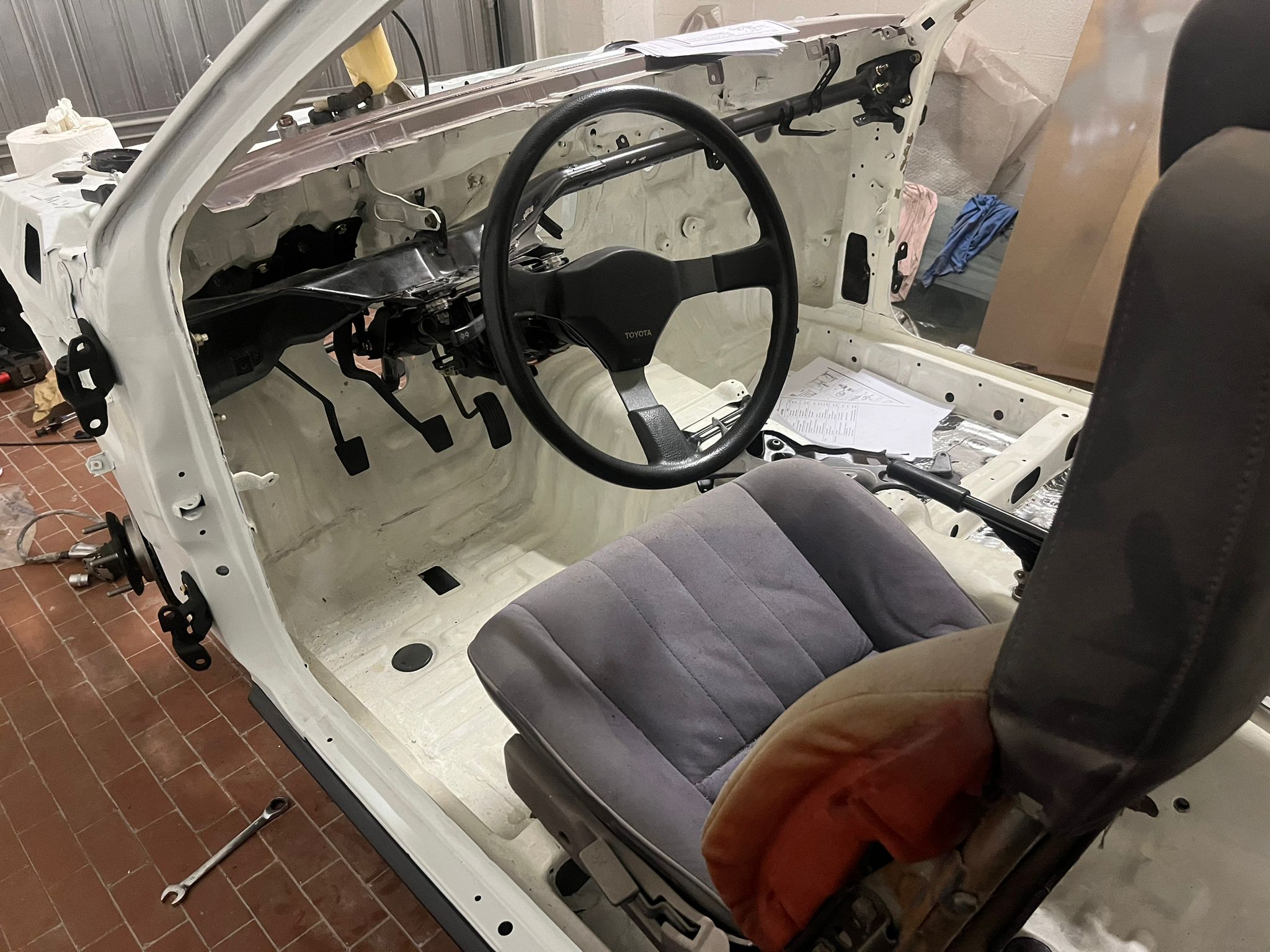

Now some update! Finally, after almost a year and a half, it's on the wheels again! Big Grin
I've added insulating material on the floor, added the quarter windows, assembled (almost) the pedals and heater unit.
[Image: AEU86 AE86 - Blaze's AE86]
Next steps are:
- Rebuild the brake calipers and mount them
- Finish to fix door and other body parts
- Start with the wiring
- Mount the windshield
Once all of these stuff are done i will start with the engine rebuild, mainly because this way i can clear some space at home Dodgy

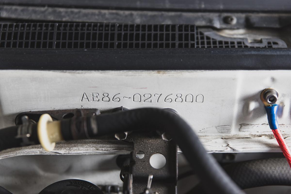

In principle the firewall ID plate in Europe (and Japan) doesn't contain a VIN as back then it wasn't a mandatory standard yet. In the US they did get a VIN on both the firewall ID plate and the firewall. So in Europe the plate contains the serial number, trim level and other details of your car. The serial number is also stamped on the firewall itself.

And this is the same serial on the firewall:
Most countries, like the Netherlands, only care about the serial on the firewall. You can easily tamper with the firewall plate, but not that easily with the stamping of the firewall. Also some countries (like Belgium) sometimes feature different plates riveted over the firewall plate as their legislation in the 1980s required that.
So you should be able replace the firewall plate without a problem as long as it contains the same serial number. You can buy them online and get the either engraved or stamped. Toyota used both methods for the AE86, where it depended on the factory which methods they used. Tahara (A52/A54) used to engrave them (like seen above) while Higashi (M21) stamped them. It is also important to note that they are stamped outwards, so from behind.

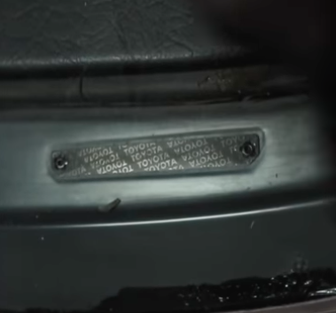

There is also this spot on the dashboard metal part, where it clearly miss something
But for what i was able to find it should only be a metal tag with Toyota written all over it, like this:
On newer car usually in this spot you should be able to see the serial, but these doesn't seems the case!
Wondering if this tag can be find somewhere or made it, or if it's best to leave it like this o cover it.
I'm just trying to figure it all out before putting the windshield back on, then i think it would be very difficult Big Grin

As far as I know the European AE86-es never got the serial under the windshield. The USDM ones did get them with the VIN under the windshield:
I guess it must have been some legislation in the US mandating this.
