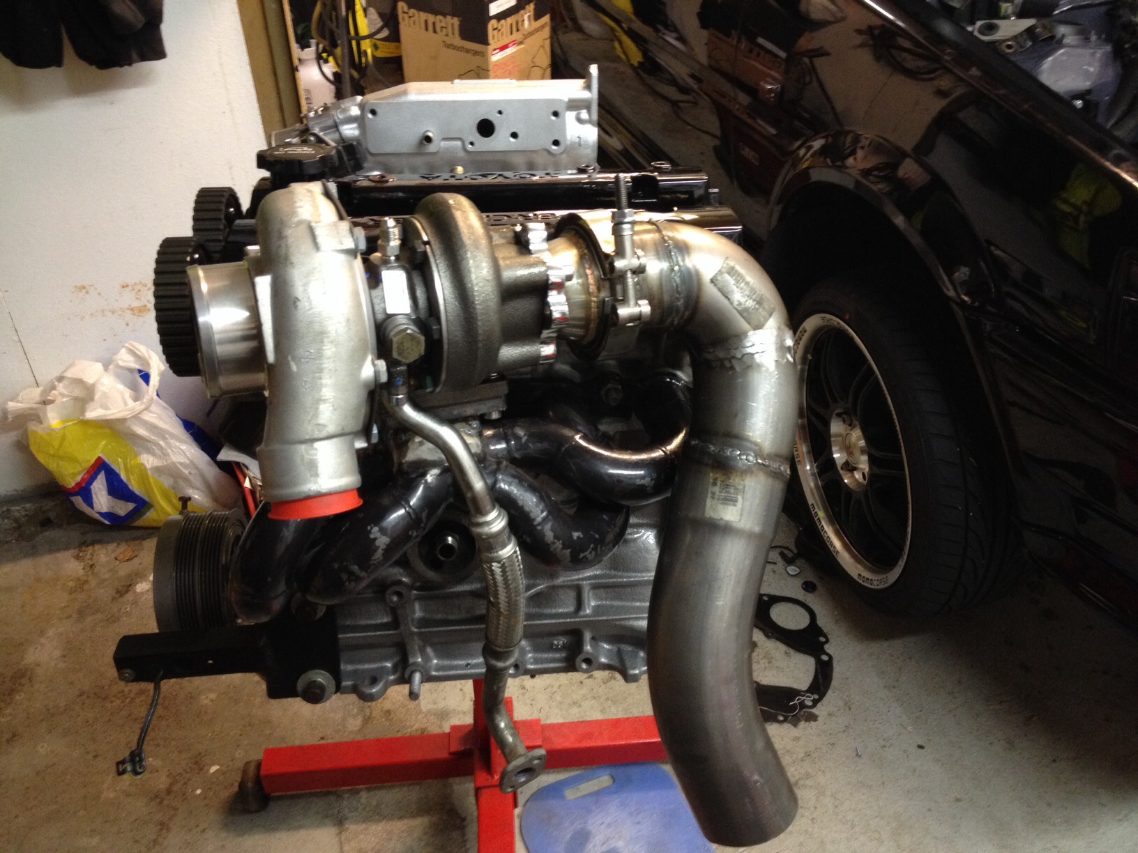

Blacktop out 4AGTE in
Se oli jo ostaessa

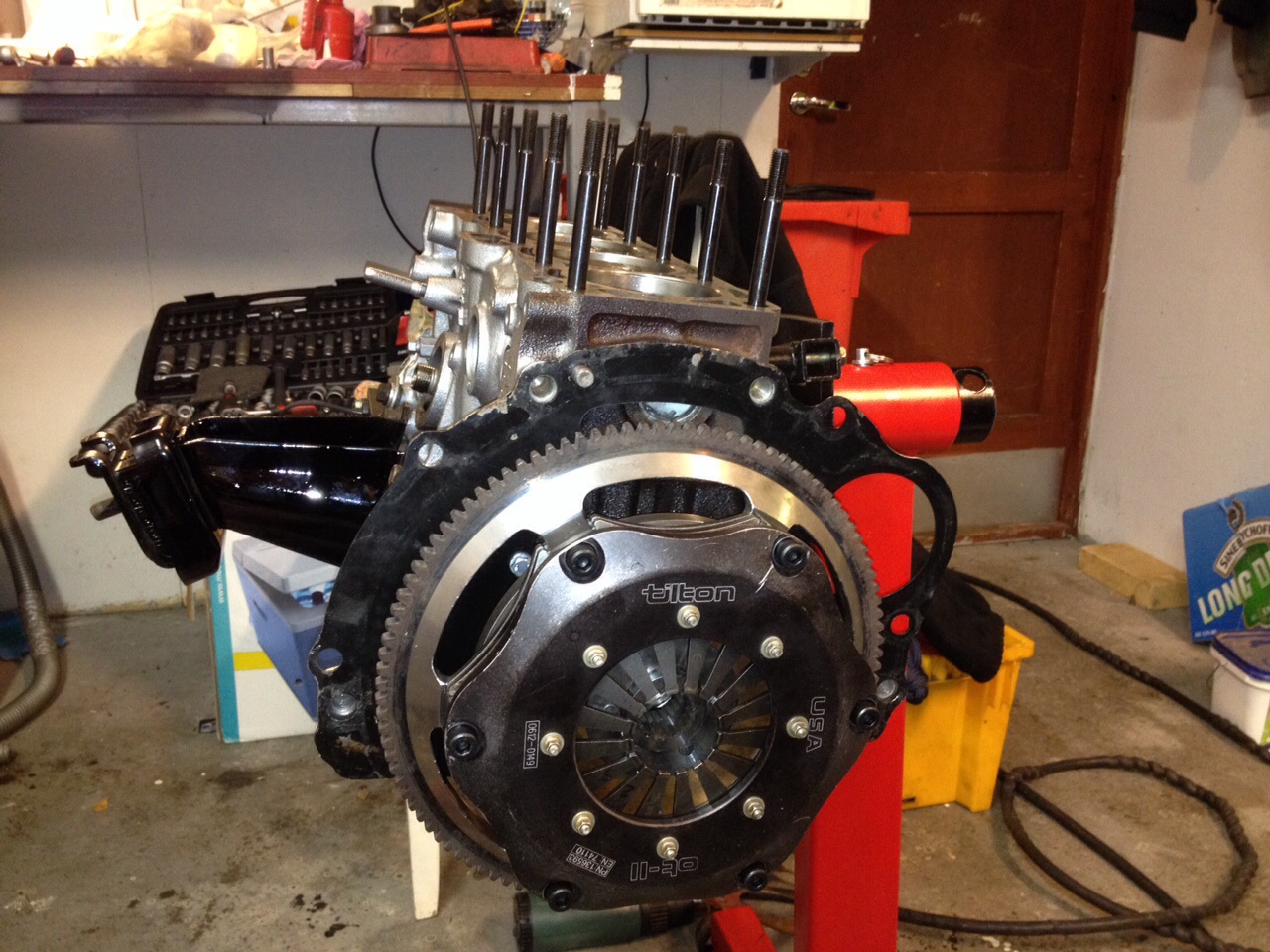

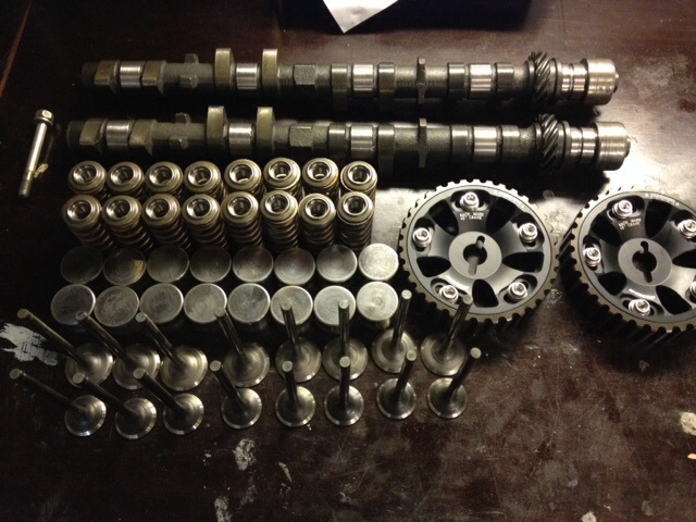

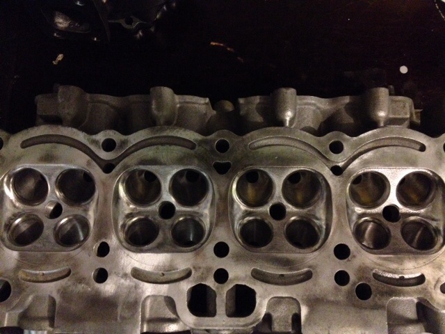

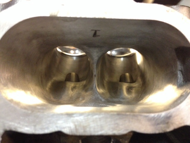

More parst collected Smile 7.25" twin plate clutch and flywheel also coming soon. My friend is fabricating adapter plate to my gearbox. Ported head is ready. Few small parts still missing. Maybe i fire it up before christmas Thumbs up! next month menu includes only noodles noodles noodles Yummie!

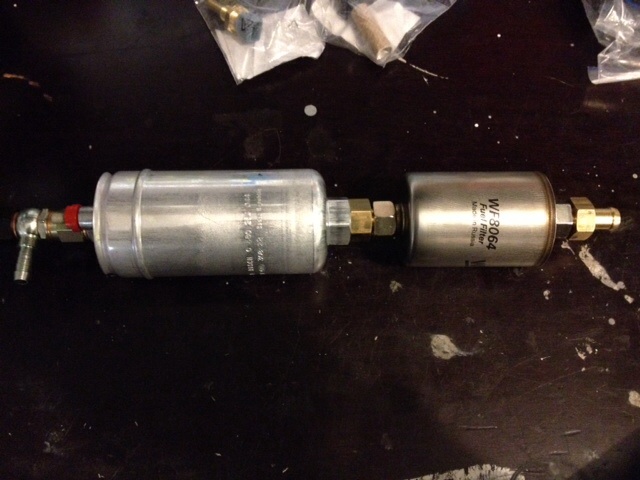

mä ite fundeerasin et laittas 040 bossin tankin sisään. walproo ei tule laitettuu pitävät kovaa ääntä ja tahtoo tuotto paineel olla pien.
Ready to rock. At last all missing parts arrived. Little problem with piston rings, third one were right. Clutch and flywheel are super light, have to weight them tomorrow Yummie! .now i can start building the engine Thumbs up!

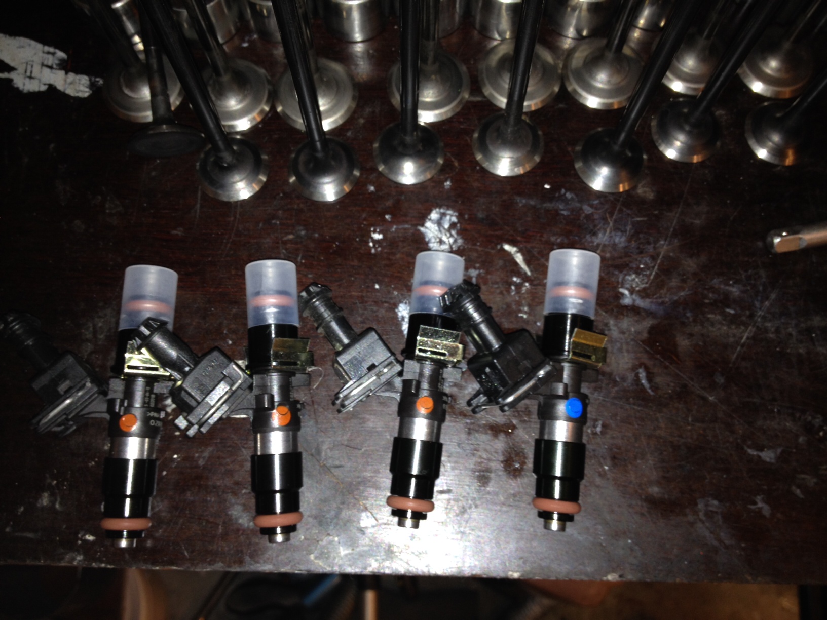

injectors for E85 and 40mm wastegate. digital valve spring tester coming from ebay. then i can start shimming valve springs.

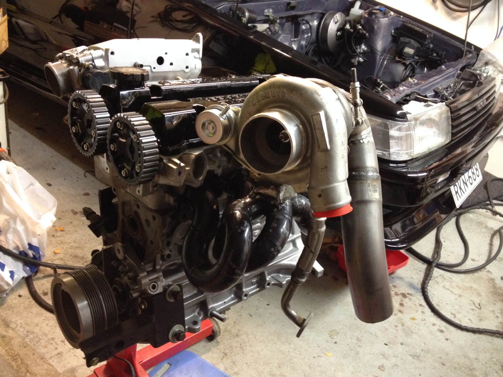

12-06-2013, 10:08 PM
you've done a clean work. Thumbs up!
what it your HP target?
