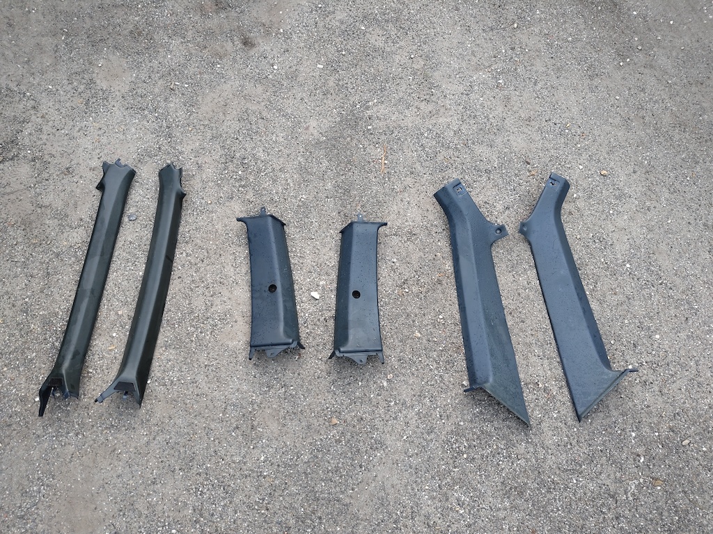

I personally thought my A pillar covers were discoloured, but I found these ones have discoloured in the same way when you compare them to the B pillar cover:
[Image: AEU86 AE86 - Banpei's two door panda Trueno from Japan]
On the inside, they are blue, but on the outside, they are brownish/dark grey (I'm colour blind, so that's my interpretation). Maybe they suffer more from UV due to being right behind the windscreen? Or maybe Toyota used the wrong dye? And I see the same thing on the front section of the mid-console, where one part is blue and the other one brownish/dark grey. There is no fade in the other part, and it abruptly changes from one part to another.
Do other people have the same experience as I do?

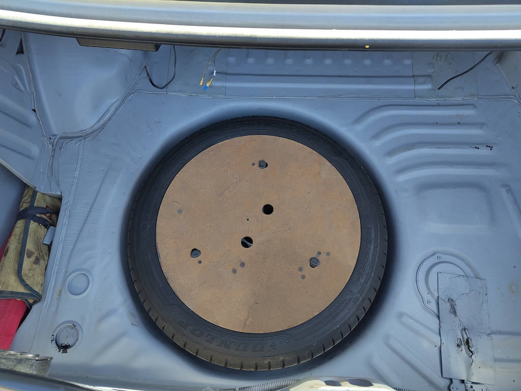

I fitted the spare wheel cover:
It fits fine on a 14-inch wheel, so no issues there.

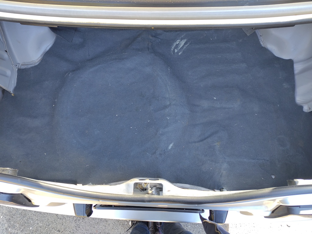

Last week, I also cleaned the boot carpet. It took 5 rinses with just plain water before it became clear(ish), and then I let it soak for 2 hours in detergent. Then it took another 3 rinses with water before the rinsed water was clear again. And the carpet still looks like this:
There is still a paint smudge and grime on it, but it's heaps better than it was and at least I know it's clean. So, for now, this will do fine.

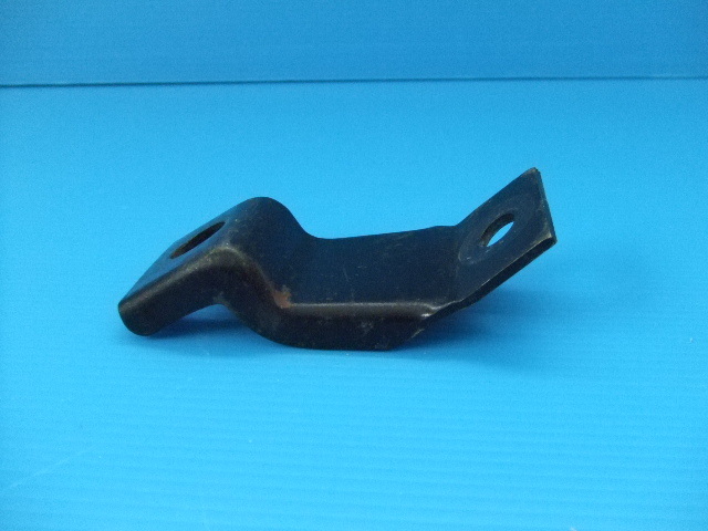

I also found some official Japanese Cibie brackets for sale on Yahoo Auctions. Buy-me-now-price was set at 180 euros! Huh
Naturally, I'm not a fool and refuse to pay 180 euros for a pair of used brackets! Big Grin

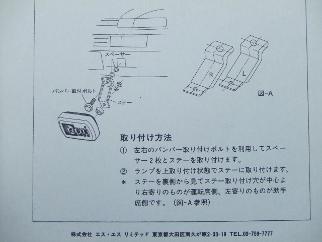

But the seller was kind enough to also include the official documentation in the classified ad:

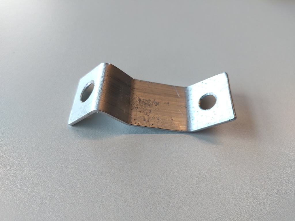

I took the drawings to guesstimate the dimensions based on the size of the hole in the photos and created my own bracket:

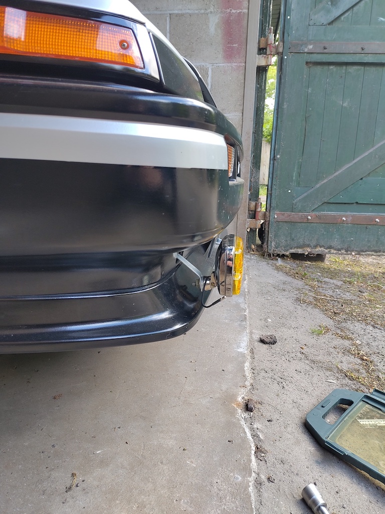

And today I test-fitted it:
The first issue is that my measurement of the bolt holding the bumper was too tight, and therefore, the hole was too small. This also meant that the calculations were off...way off...
It's more apparent in this photo:

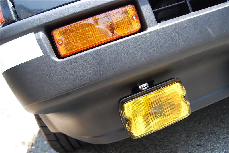

I also tried to fit one of the foglights, but it was way too close to the bumper and the lip. I think they need to sit at least 2 centimetres lower. This means the sloped section (angle of 45 degrees) needs to be at least 2.8 centimetres longer. It also needs to be about 5 millimetres further out to create a bit more distance from the lip.
Once I have them right, I'll share the dimensions of the brackets.
In version 2 of the bracket, I'll address this and make it much longer.

It looked fine until I mounted the foglight:
That doesn't look right...

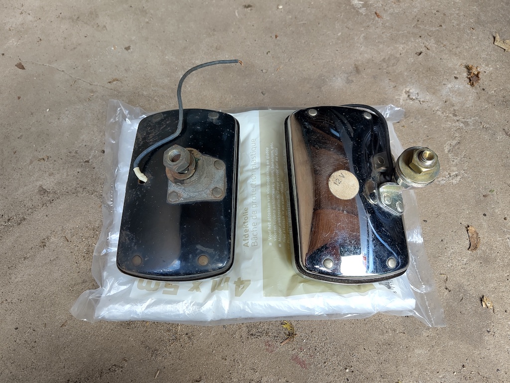

Then I found out there are two variants of the mounting plate:
Doh! Banging head

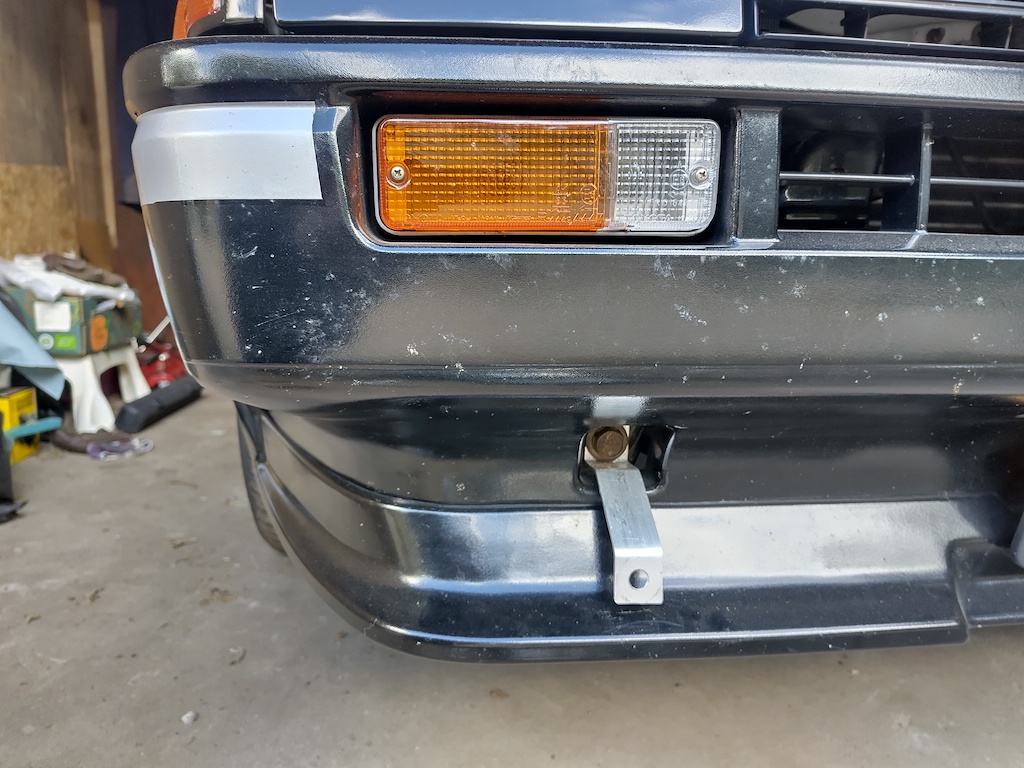

In other words, bracket v1.0 was actually nearly correct for the other type of mounting. However, I'm not planning to mount these as they are slightly corroded.
So, back to the drawing board for a design similar to this one:
