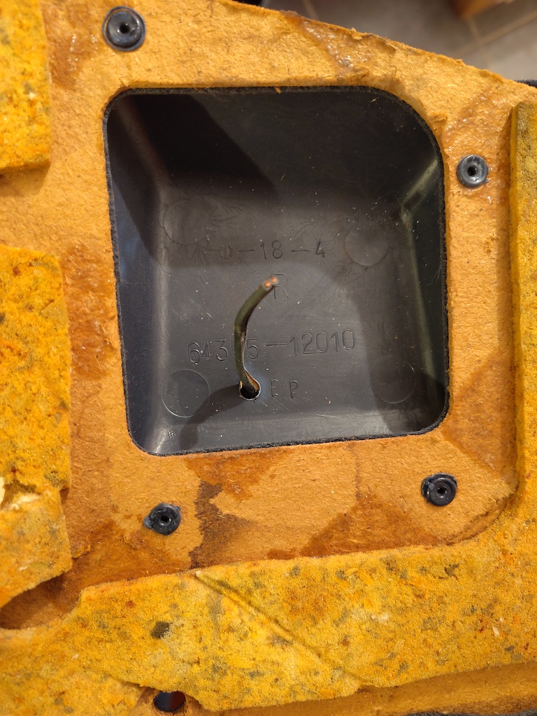

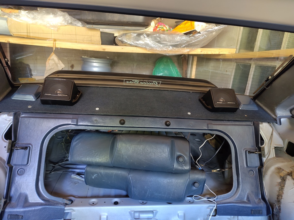

This is what I mentioned earlier, my top covers are fastened by some melted plastic:
[Image: AEU86 AE86 - Banpei's two door panda Trueno from Japan]
I remember having the same attachment in my first AE86.
The only way to remove them is by drilling out the molten parts. After this, you end up with some small stands which you can use screws on to fasten them again.
I also checked the part number (64355-12010) and it's non-existent in the Toyota parts catalogue, so I wasn't crazy after all... Big Grin

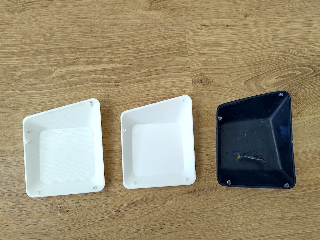

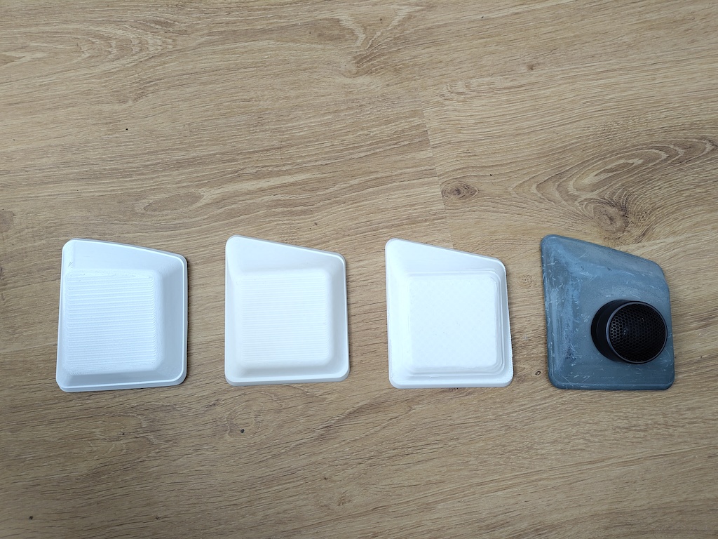

Now this is my progress with the copies:
The first version wasn't a huge success, and I quickly mocked up a second one. This one also has some minor flaws, but it's nearly there! Hurray!
I already have the final design done, including a curve on the angled side and stands with an M3 thread, but that's still waiting in the queue of the printer. Once it starts printing, it will be a printing marathon of 6 hours. I couldn't print it earlier as I wanted to print it in PTEG, and the filament only arrived this afternoon.
I also picked up the dark-blue interior paint I had made for these parts this afternoon.
Once I have the finished prints and painted them, I'll share photos of what they look like.

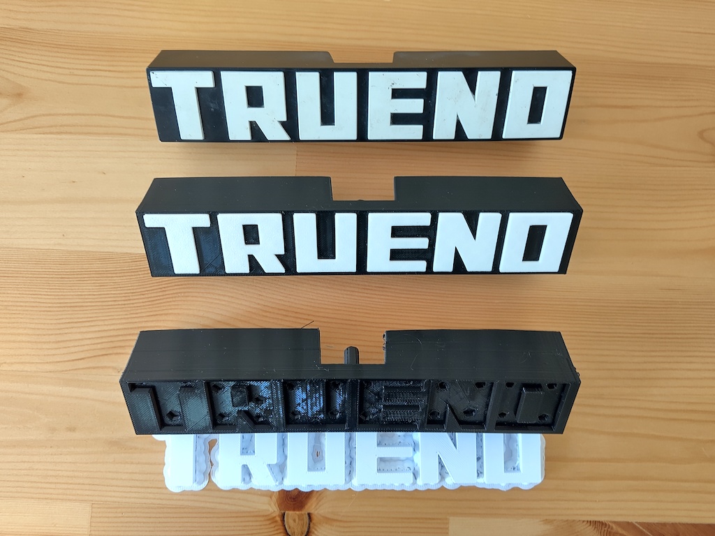

At the bottom we have the Trueno badge printed in PTEG:
The overall quality of the print is much lower than with PLA filament. You can clearly see printing defects on various edges and ridges are much more present. Apparently,, PTEG doesn't flow that smoothly, and this meant I had to do a lot more sanding than I initially thought.

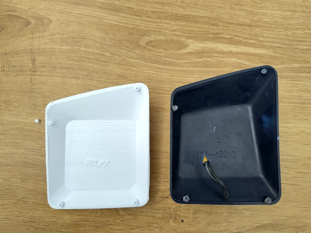

For the parcel shelf covers, the final PTEG print is on the left side:
I decided to print them in white as the white filament was still in the printer and I didn't fancy switching it back. It took 6.5 hours per side to print! Huh
On the underside, you can see the feet are in the correct position now:

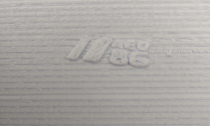

I found out PTEG is much more brittle than PLA; one of the feet broke off when I removed the supports. If I ever print them another time, I'll create them with a larger diameter.
You can also spot an Easter egg on the underside!
A tiny AEU86 logo! Big Grin

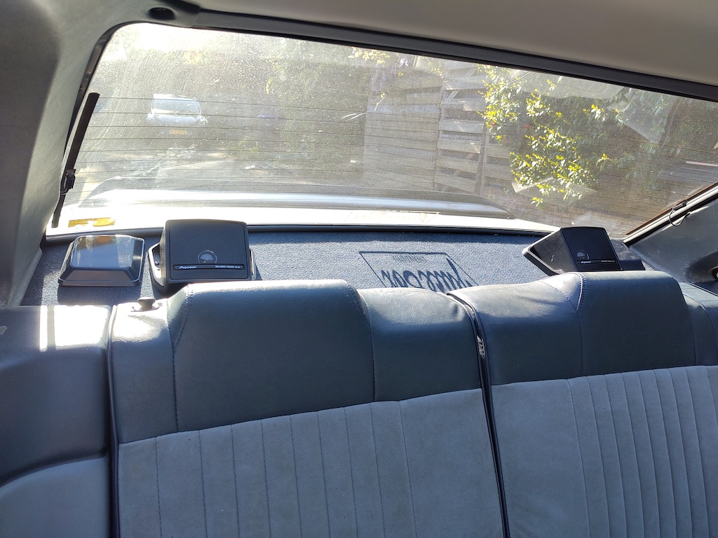

Last night I cut the new parcel shelf and glued the blue fabric on. I also painted the parcel shelf covers and mounted them on the shelf:
The fabric was glued on the old parcel shelf, but the old softboard was already suffering from delamination. So I managed to peel off the fabric with the top layer of the softboard. This made it much easier to glue it on.
This afternoon I went to the garage, mounted the speakers and fitted the new parcel shelf to the car:
It's a perfect fit!

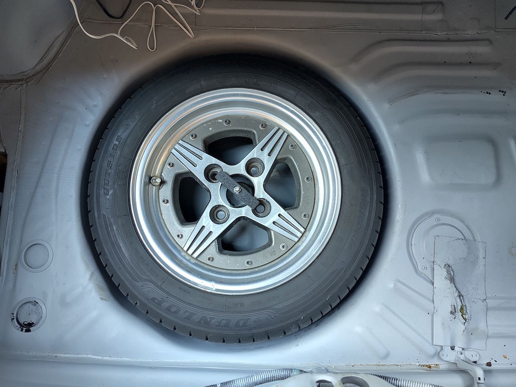

My car didn't come with a retainer for the spare wheel. I mocked up something in Freecad with a stepped-down holder using the dimensions of the Black Racing wheels and the OEM Toyota wheels.
I can improve it by also adding the Almex Y3B dimensions and changing the hole to a six-sided M8-sized hole. At least the current one is functional, and I no longer have to suffer from clunking noises on every speed bump. Big Grin

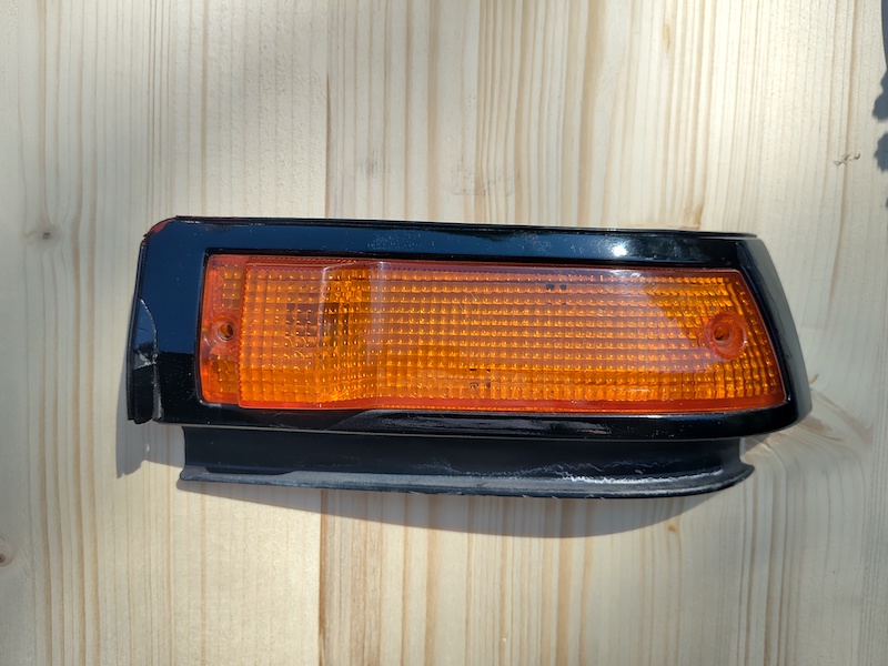

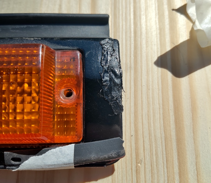

Some time ago, I complained about one of the side markers being hazy and discoloured. I found a really cheap one with a small defect on Yahoo Auctions:
So I tried to fix it by plastic welding it:
And then I filed it down to make it smooth again:
I left the weld on the rear of the side marker, as that's where I thought it would need reinforcement.
This is before the first (guide)coat of paint:
Then I found that there were still some visible marks, filled them up and sanded them down. I had a couple of rinses and repeats to make it smooth. I forgot to take photos of the final result, but it looked decent enough. Under a certain angle, the repair was still visible. So I also fitted this side marker to the car this afternoon. Unfortunately, the weld on the rear was pushing against the front fender too much. This then made the crack visible again, but with the cracked paint all my work was in vain... Banging head
I'll now move to plan B: put the side marker in the oven to make the glue melt, and then transplant the orange part to the original side marker.
I also finished the Trueno bumper badge and fitted it to the car. Even though I test-fitted it yesterday, I didn't realise the PTEG version was lacking one important aspect: it didn't clamp well enough on the bumper shrouds! Banging head
The badge is clamping itself on both ends of the badge as seen in this picture:
The retaining bolt on the rear isn't holding it in. It's there purely to prevent theft or falling off when it's too loose.
The badges printed in PLA clamped fine, so my guess is that it's caused by me sanding down the printed badge to remove print defects. Confused
I did fit it to the car, and it looks like this:
I'm happy with the way it looks, but unfortunately, I have to print it all over again.

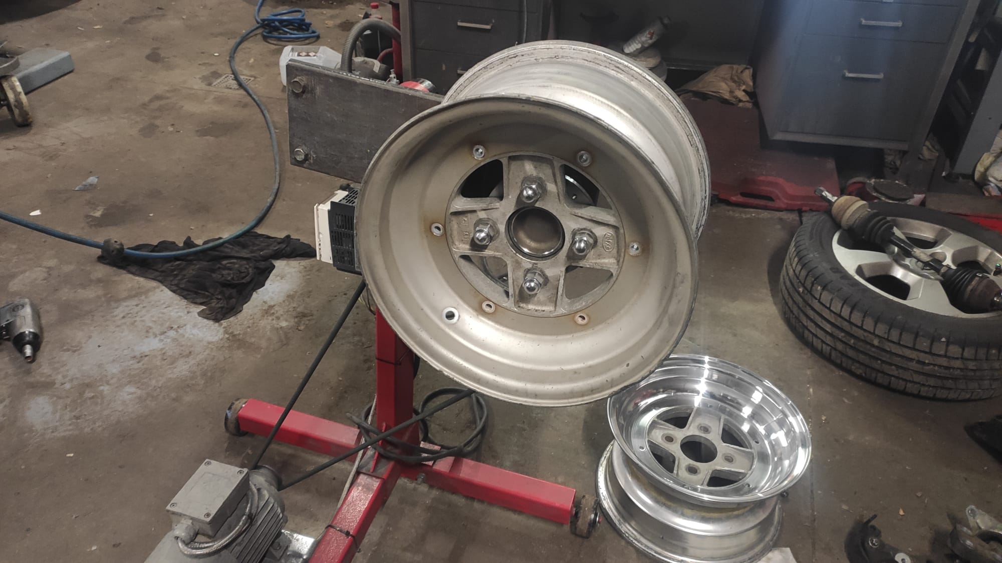

However, if it's only polishing I'll do I'll probably use the same method as last time: I attached a rotational buffing tool to my cordless drill. It didn't give me a mirror finish, but it worked well enough to revive the shine.
This was the result of my efforts seven years ago:
Unpolished (left) versus polished (right)
