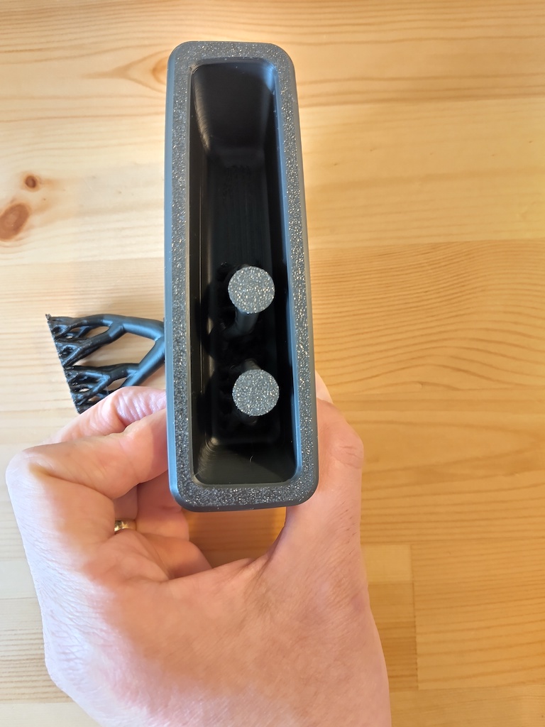

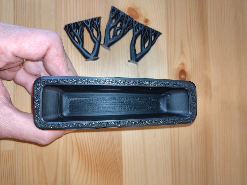

This is what the supports look like:
[Image: AEU86 AE86 - Banpei's two door panda Trueno from Japan]
The slicer creates a tree-like structure to support and makes it easy to snap off without damaging the printed piece.
This is what the bottom of the cup looks like:
It still needs sanding, but it's not with the horrible loose filament dangling down that I had the print without the supports. Thumbs up!

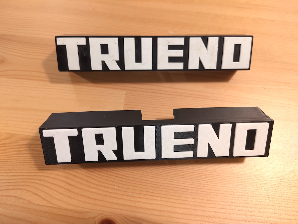

After some more failed attempts, I managed to create this:
It's becoming more difficult to spot the difference between the original and the copy! Hurray!
This is the progress I made:
The second last from the top are the supports I used for the black holder as I printed it the other way around. I used to print it with the front face down on the plate, but adding supports to that proved to be unreliable. The supports would leave some uneven surface behind and that made the white Trueno characters difficult to fit. So, I decided to turn things around and print it from the back to the front.
Up close you can see the difference between the two badges clearly:
The printed Trueno characters have a crinkled surface due to the pattern on the printing mat. Apart from that, I'm not dissatisfied!
Tomorrow I'll test-fit the printed version to the Trueno to see if everything lines up fine. If that's the case, I'll have it printed in ABS.

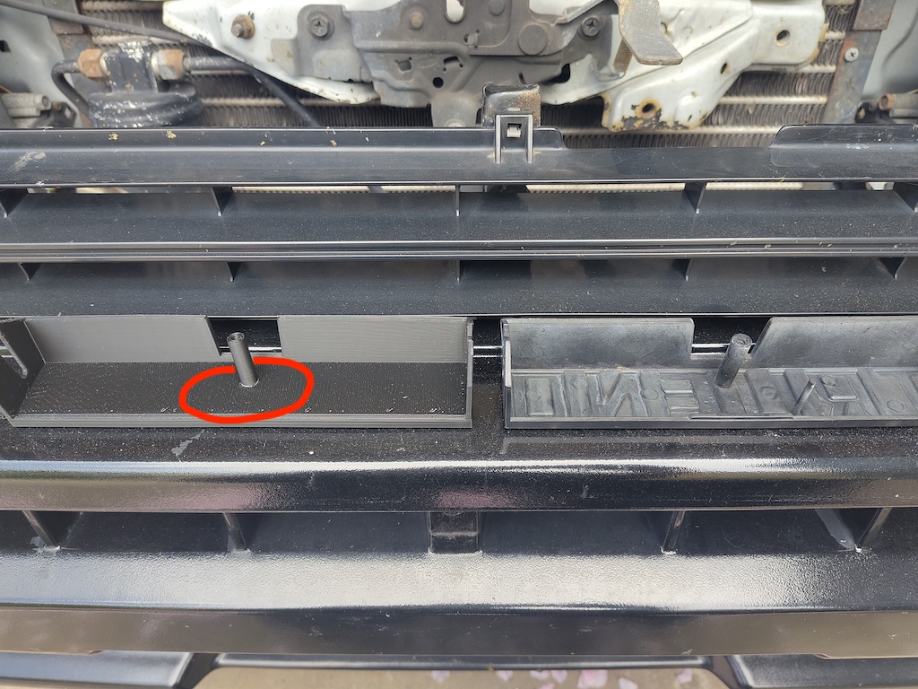

However, there is still one small flaw in the design:
The support is about 2mm off, so I had to push it in a bit hard to make it fit. The support is clearly weakened by pushing it in. I'm now printing the final version with the support moved 2mm and let's hope it's a good fit this time.
