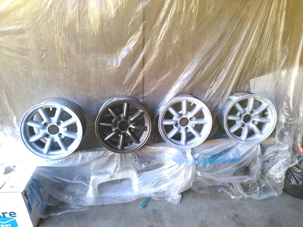

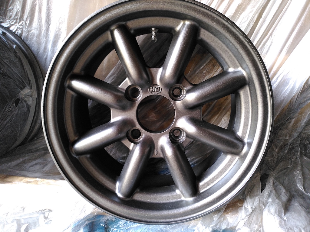

Small update on the Black Racing rims. After sanding them down I cleaned them thoroughly and applied two layers of primer. I didn't take pictures of this proces, but I do have one picture when I applied the first layer of paint to the first wheel:
I ended up going for cheap ass Motip 51047 paint which appears to be somewhere between Watanabe gunmetal grey and bronze.
After three layers of paint I applied three layers of clear coat matte:
I'm quite pleased with the results. Not bad for a rattlecan job inside a shed.

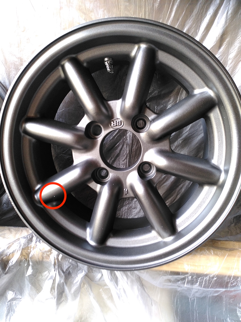

There are a lot of flaws, like for instance this wheel where a spec of dust settled on the clear coat when it was still wet:
And you can still see some scratches of my sanding action, so that's not perfect either. But it was never my intention to make them perfect. If I wanted that, I would have sent them to some company that would coat them and make them perfect. I had low expectations to begin with, so I'm pleased enough. Wink
