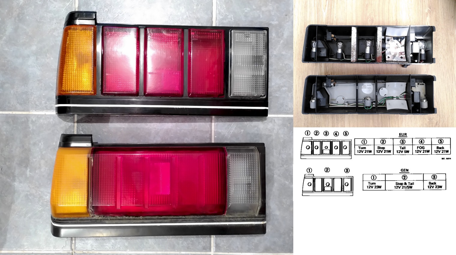

I found out back in a day that there was an issue with the electrical connections not being 100% the same between the EUDM and JDM tail lights. To overcome this, I mounted the inner guts of the EUDM lights (containing the wiring and light sockets) right onto the JDM ones. This works, but there is an issue as the Japanese has a single lens with a dual fillament bulb handling the brake lights and the tail lights in the middle section, while the European has three separate lenses in the middle. I think this picture makes it a bit clearer:
Top ones are the EUDM and the bottom ones are the JDM spec tail lights. The issue is that there is only a single lens for the brake light, tail light and fog light whilst these are separate bulbs. This is not allowed, but hardly anyone would ever notice. However someone did: I did encounter a warning at the APK (MOT) renewal in 2017 that I should address the tail lights as the single lens wasn't allowed and also my reflectors were corroded (as you can see in the picture above). So in 2019 I de-JDM-ed the Carina:

I started with figuring out the wiring. I found out the following connections were present on these connectors:
EUDM connector on the left, JDM connector on the right.
The pinout: (pin 1 on the top right, pin 6 on the bottom left)
Code:
pin EUDM    JDM
1   reverse reverse
2   turn    turn
3   tail    absent
4   fog     tail
5   ground  ground
6   brake   brake
Edit: I have reversed the pins to match the female connectors in the EWD, which are naturally mirrored
So it's clear I need to move pin 4 on the JDM tail lights to position 3 and everything should work as a charm! Thumbs up!

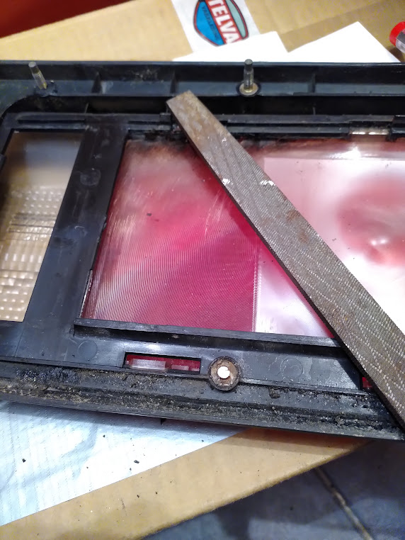

I also made a first attempt in replacing the snapped off bolt. The issue is that the frame of the tail lights has been moulded around these bolts, so replacing them won't be easy. So my idea was to drill a tiny hole in them and then step up the drill a notch every time. Then tap some thread and insert an M5 threaded rod and glue it with some metal glue or JB Weld.
Step one: make the surface as flat as possible to allow me to center the hole:
My first thought was to use a punch tool to make a good center, but I quickly abandoned that thought as I would need a rigid surface underneath the frame (and lens) and that probably would damage it.
So instead I used a 0.5mm drill and it was good enough near center of the bolt. Then I increased size to 2mm and it now looks like this:
For M5 it should go up to 4mm and then I would be able to make a thread. Fingers crossed that this will work out as intended. Wink
I will cut a rubber gasket using 2mm EDPM rubber that I found at the hardware store, so more will follow! Hurray!

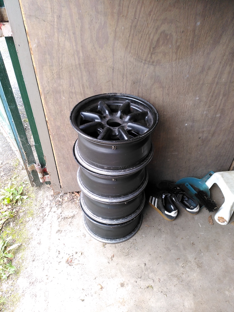

Also on my todo list are to revive the Black Racing rims:
They require new tires, but before doing so I'll paint them. I'm not sure if this will be a diy job or whether they will be powder coated (like I did on the Celica Supra rims). These rims are cheap knock offs, so do they deserve such treatment?

(09-01-2023 09:21 AM)decryphe Wrote:  Interesting stuff. Didn't know that each light has to have its own lens.
I think it was this bit:
Quote:De glazen van de lichtarmaturen mogen niet zodanig zijn beschadigd, gerepareerd of bewerkt dat de lichtopbrengst en het lichtbeeld dan wel de functie nadelig worden beïnvloed.
Which would translate that they are not allowed to be damaged, repaired or modified to limit the amount of light emitted and influence its function in a negative way. As the brake light and fog light both were on the outer side of the Fresnel lens, they would give a distorted light that wouldn't be focused. So yeah, not according to spec and quite open for interpretation whether they influence the working in a negative way. Banging head

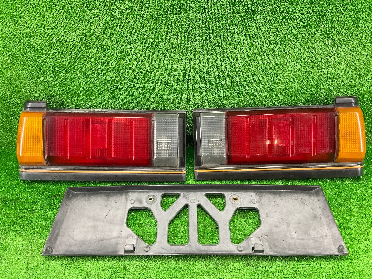

Today I polished the Japanese tail lights. Here's a before (left) and after (right) picture:
They really came out nicely and no longer look faded. However, if you compare them against the European tail lights you can obviously see they have a much less deep orange and even a bit more yellowy. It makes me even suspect they are supposed to be yellow from factory.
Mine aren't GT-R items and probably ST or SG spec. Comparing them against the ST coupe tail lights gives me the confirmation they aren't deep orange:
Edit
More proof the indicators are yellow.
Set of 1985 GT-TR TA63 tail lights:
Set of 1984 GT-R AA63 tail lights:
Next step is to fix the bolts, paint the frame and cut the rubber gaskets.

I also had the tires removed from the Black Racing rims:
The plan is to paint them this week in gunmetal grey and get new tires next week.

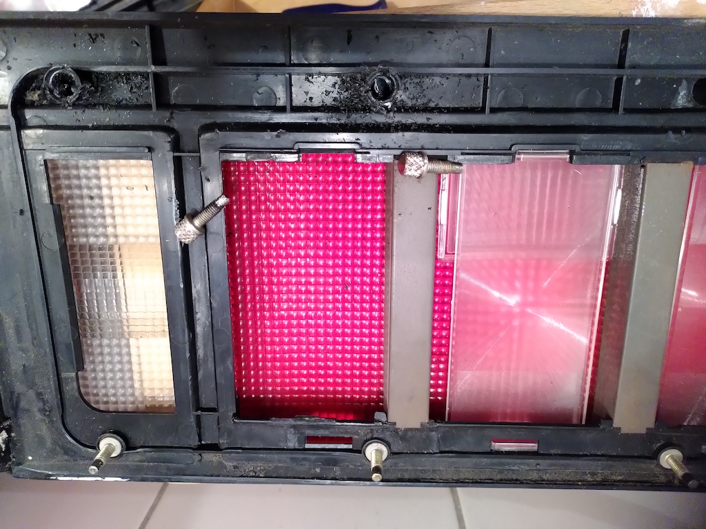

Finally, I also made some progress on the JDM tail lights. I tried drilling a deep enough hole into the base of the bolts that snapped off. Apparently, I overdid it a bit and the first bolt I tried became too hot and melted the plastic slightly to sink into the frame. I then decided to change my plan and remove the base of the bolt (as it was now a bit loose) and replace the snapped-off bolts with bolts from an old EUDM tail light that I sacrificed for this purpose. I didn't try the heat trick on them, but immediately took my dremel and removed some material.
And then inserted the bolts into the JDM tail lights and filled up the gaps with glue:
Next thing on the list is to paint the frame black and red and then they should be ready to be installed again! Hurray!
