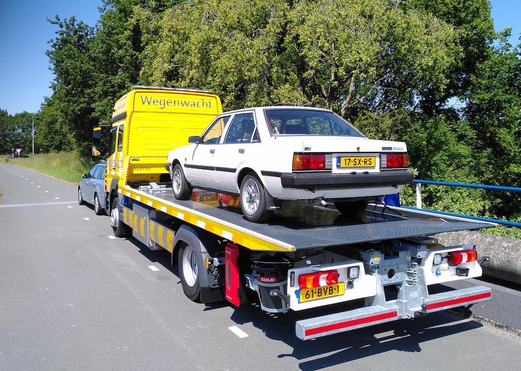

I blame myself for not driving the car more than across town before letting someone else drive a stretch of the highway. A head gasket failure happened and the engine overheated. The roadside assistance tried to patch it with some sealant to be able to drive back home, but those efforts were fruitless. So a tow truck was called in to help out. Sad
The person interested in buying the car is still interested when the engine is fixed, but I have to see what costs are involved in doing so. It will take some time and thinking about my next steps... Confused

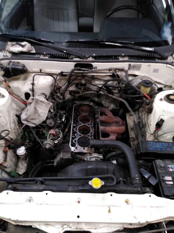

I dropped by the garage earlier today and the mechanic already popped the head:
The head had already been picked up by a specialist and we'll hear in a day or two whether the head is salvageable. It looks like the head had been leaking on the number 4 cylinder for a while, but the block and pistons seem to be fine.
I also left them a Toyota T-engine handbook to save them some time to work out the torque specs and stuff. They much appreciated that and wished more customers had one and brought them along when their cars are in need of repairs! Big Grin

Unfortunately bad news: the head is cracked and the radiator is damaged by the overheating. This means I have to find a new head (I did find one via a contact) and either a new radiator or have it repaired or re-cored. In total this will be a very expensive repair. Sad
