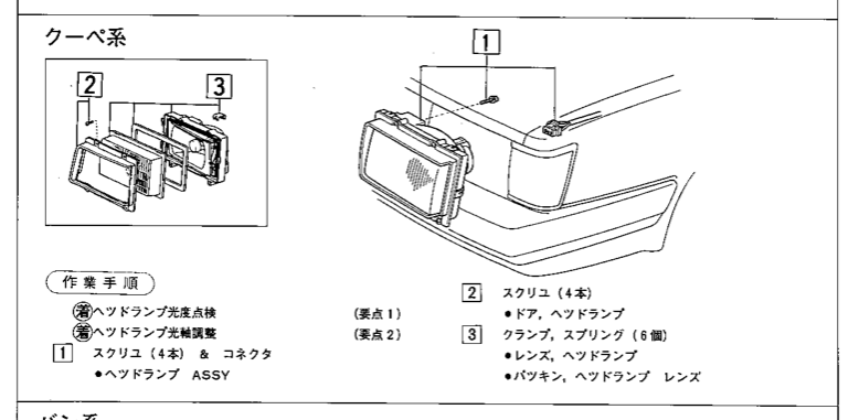

Final point is that the headlights need adjustment. I tried to find the adjustment screws but there aren't any on the headlight unit itself and none on the bracket. Also both the Carina workshop manual and Carina owners manual don't tell you how to adjust. I'll go through the Japanese workshop manuals and see if I can find it in there...
I found this in the Japanese workshop manual and [1] says there are four screws at the back to adjust. I was expecting them at the front like with the Trueno. Banging head
07-06-2022, 01:53 PM
Post: #223
Another week, more progress! Hurray!
There are two hexagonal bolts at the back of the lamphousing and they do adjust the headlamps. The upper one adjusts the horizontal axis and the lower one the vertical axis. So headlamps have been adjusted now.

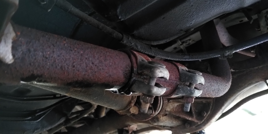

I also looked at the exhaust and found it in this condition:
I loosened the bolts and found the metal was in okay condition. The problem seemed to be that due to rust the gaps were bigger and hence it was leaking.
So I applied some exhaust putty and waited for it to cure:
After the third attempt it is now fully sealed!
