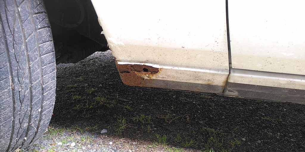

Especially the rust part was important as I already have quite a lot on the surface of the car:
[Image: AEU86 AE86 - Banpei's new TA60 family cruiser][Image: AEU86 AE86 - Banpei's new TA60 family cruiser][Image: AEU86 AE86 - Banpei's new TA60 family cruiser]
But on the underside things weren't worse than last year. Smile

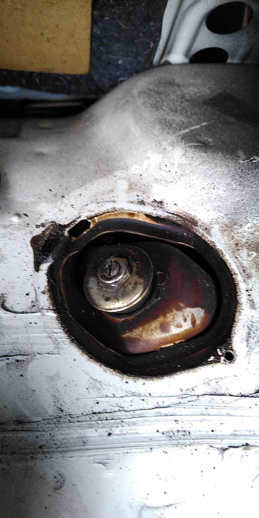

I wanted to replace the rear shocks, but I don't seem to be able to get the top part loose. I forgot to take a photo, but it has a slotted shaft with nut on top. I tried to keep the shaft from rotating while trying to undo the nut, but I failed. Anyone got an idea how to get these things loose?

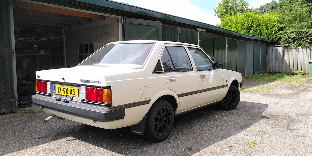

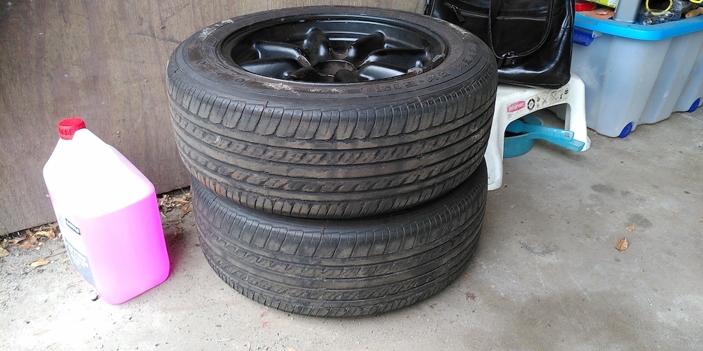

Last week I bought back my old Black Racing rims from r.ave. I tried fitting them to the Carina a few years ago and for fun tried once more today. So here's the Carina on Black Racing versus Celica Supra rims.
Front:
Rear:
I do like the fact these rims are black and it really suits the white/black theme of the car. However the gap is way too large! Huh
So maybe time to throw in the set of Apex AE86 springs I bought years ago? My rear springs are rusty as heck, so it wouldn't be bad to replace them. I would need KE20 top hats to fit the AE86 springs on the Carina front struts. Anyone got a spare set of KE20 top hats? Tongue
And I also need a new set of tires on them as these cheap Chinese tires are the worst tires I've driven on. They really scared me as they have no grip at all! Besides that, r.ave used them on a drift session and managed to get the rid of the thread when drifting on a wet surface.

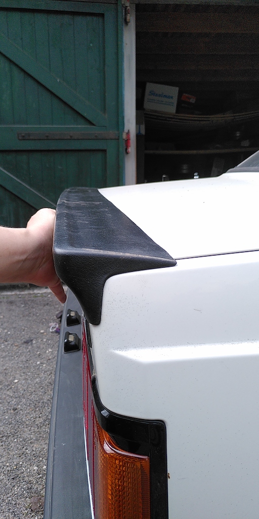

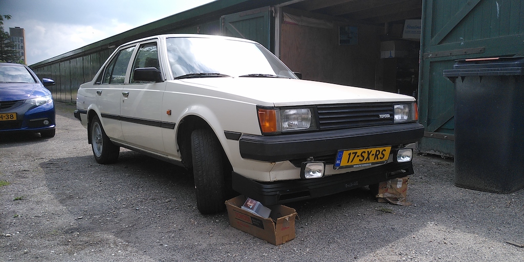

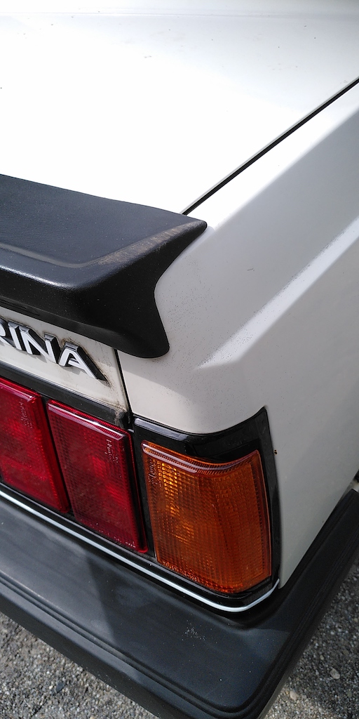

As I was cleaning up and sweeping the shed, I came across my Carina A60 spoiler set by Foha. For fun I tried it on the Carina as the last time I did this was over 10 years ago:
I like the rear spoiler, but I'm not so sure about the front spoiler. I much rather have a subtle chin spoiler like this one:
So I'm trying to book a slot for MOT next week. Keeping my fingers crossed. Wink

Those BR wheel look way better if you ask me. Just lower the car a bit and the gap is solved.
And indeed, the worst tires i've driven on as well, really dangerous.
I like the spoiler and bumper, but i get what you mean with the chin spoiler.

I also tried to remove the shock absorbers once again. According to the workshop manual you need to use a screwdriver to hold them in place:
But no cigar:
Last week I already drenched them in penetrating oil and did it once more today. I'll try again next time. Worst case I have to cut the rubber bushes off with a hacksaw (I don't have power in my garage) and then hold it with a set of pliers.

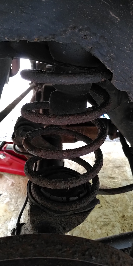

The reason why I'm so eager to get them off is because this is what my 40 year old springs look like:
And I can't remove those without removing the shocks first as the shocks have been extended fully and undoing the bottom bolt only doesn't allow me to detach it from the axle...

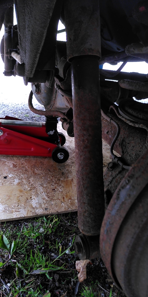

And the whole shocks, links and axle don't look much better either:
So after MOT it will be time to remove all the crud, use some rust reverser and then paint it black again.

One thing you could try is lifting the rear in a way to relieve the tension from the springs as much as possible before you try to undo the bolt. Even if you can't reach the shaft to hold it in place some hits with an impact wrench might help.
Last but not least and a bit more drastic. IF don't get enough leverage for the screw driver (i.e. it's slipping) you could use a dremmel with a small thin cutting edge to make the slot slightly deeper.

That is a stupid design. Do you have a ratchet with screwdriver bits? Maybe that gives you more strength. And maybe loosen the nuts a bit with the car still on its wheels before jacking it up and fully loosen the nut will work?
Or as a last option without power tools, a sharp chisel will probably get that nut split in 2 after a couple of blows with a hammer.

I do have a ratchet with screwdriver bits and also an impact wrench, but the bits are actually too small to have any leverage on the shock. That's why there are scores on the one in the photo. I was planning on visiting the professional tools shop next week and see if they have bits that are larger. I'll keep the chisel in mind as a last resort. Wink
