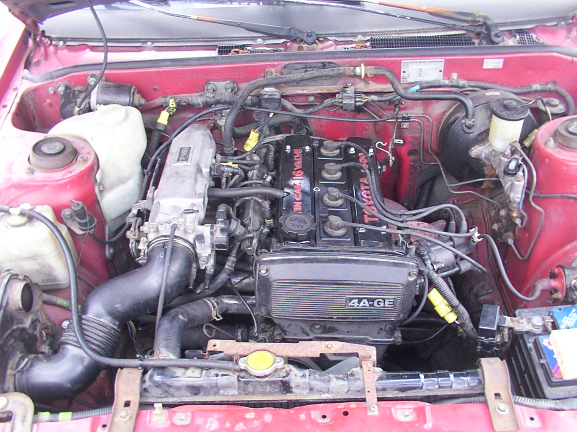

I took all the piping out from my engine but I did not remember where they connected. I am going to put a pic of piping which I remember. If you can draw st on the pic it would be awesome Smile

One is supposed to go to the fuel pressure regulator at the back of the fuelrail (dont see it in your pic), one goes to the map sensor (which is also not visible in your picture), and the last one passes somewhere around the back of the inlet manifold, probably towards the TVIS system.

MAP sensor? would you mind to show the pics of it so i can find it inside of the engine bay
