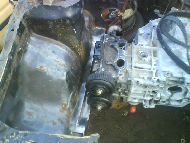

How did you tie the fabbed rails into the backbone structure of the car? (mostly the remaining part of the rails and the bulkhead? Any pics?
Also, aren't you affraid that you'll have tire rubbing issues? For me its a problem even without chassis rails inside the tubs. Interesting idea, you're a brave man... hope you get her running again soon. A wheel to steer the front of the car A pedal to steer the rear |

pics explain better than I can, as I have said this is my first attempt, I am a Subaru performance Mechanic, I'm not a fabricator (didn't even know how to weld properly as you can see haha) and I have pretty much just gone with my gut on alot of it, so it's not 100% but close enough for scrutineers to give it the ok. You may say I'm a brave man, I say I'm an idiot. :wink:
In regards to wheel clearance ![]() I'm using MX62 LCA's, and -30 16x9, might go 17's yet, as its easier to get tyres. It's built for time attack, so a shitload of lock isn't a necessity. This is an early pic of the rail, changed a bit since. (only tacked up here) ![]() ![]() The sheet "cover" is now only 3 pieces (corner, top, bottom, in 1.6mm) ![]() ![]() P.S doesn't matter if none of you like it, I love it haha. Cheers Rhys. |

![]() It'll have interesting front geometry when you're finished, what are you doing at the rear to match the front track? A wheel to steer the front of the car A pedal to steer the rear |

I have had a friend who builds some awesome racecars, who has done all the maths for me, so the front end should be close to right geometry.
I am running, a hilux g series in the bum. From memory that plus 10 wide tyres with a fair whack of offset should push it out enough. Front track is 1493mm I want 1500 at the rear, which is the same as a 22b impreza hahaha. It may be a non perfect build but, this one will go. I have everything except a fuel system a tailshaft, and suspension, just a matter of getting it all together. |
